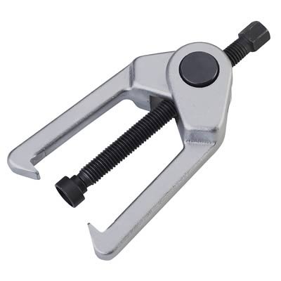

    • Someone (a non-1st gen user) recently mentioned a ~$80 puller (maybe for pitman, but doesn't look like my pitman puller) that "works".

    More details on removal for 4WD is in this thread, reply # 18 and there's lots of other tips here too -> https://www.tundras.com/threads/upper-ball-joint-removal.42150/
    The puller in question from above, which I cannot vouch for personally -> I can't find it, but it looked like what I'd call a gear puller or tie rod puller pictured below, only in my memory, it was red and black and silver, and I didn't understand how it'd work cleanly for 1st gen UBJ.
