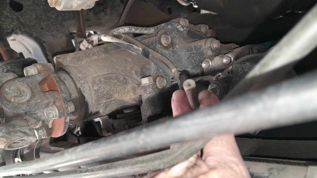

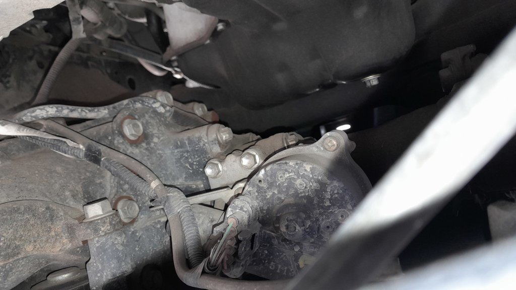

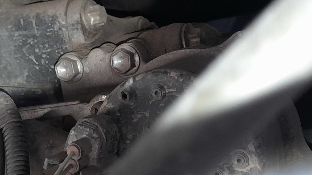

    I'm looking to put the truck in 4wd after 10 years of non-use by previous owner. I did read the stickys and did some searching. In addition to that many years of inactivity, I noticed the air/vacuum/vent tube nozzle has completely broken off (who knows how long ago), and the broken bit is still in the hose. The truck didn't get driven in the rain or off-road (I know lol), so maybe not a ton of moisture got in there? Did have some muddin as shown on the surroundings from an apparent ferris bueller style test drive from a service tech.
    Is the tube required to be hooked up to engage 4wd (is it a vacuum actuated system?), or is it just a matter of water ingress?
    Am I wasting my time (and risk being stuck in 4wd) by trying the 4wd buttons if that hose being unhooked will stop me short anyways?

    That line is just a breather, no vacuum. It wont keep it from engaging/disengaging. I would go for it and try to get it working.
    Cover that hole though (Gorilla tape?) until you figure out a fix for the broken off hose fitting. For me at least, that would be something involving JBweld haha.

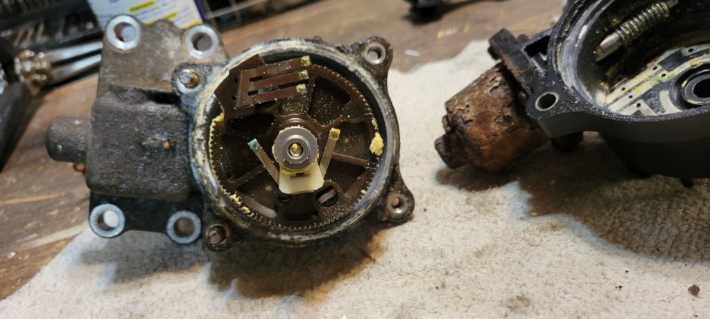

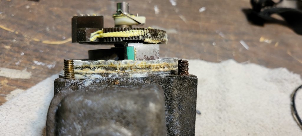

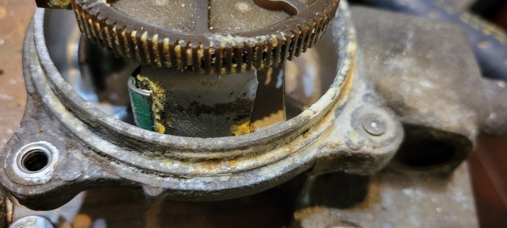

    Here are a few snaps of what I found. There is a thin O-ring under that cover, so be careful.
    Notice I broke two of the fasteners heads off... be prepared if you go in.
    Took my sweet time scraping all the corrosion off and cleaning those traces.
    Then dialectic grease on the contacts/traces/and gear. Red&tacky on the cover and O-ring.
    (this is on my 2000 AC, 288k at the time, front actuator)
