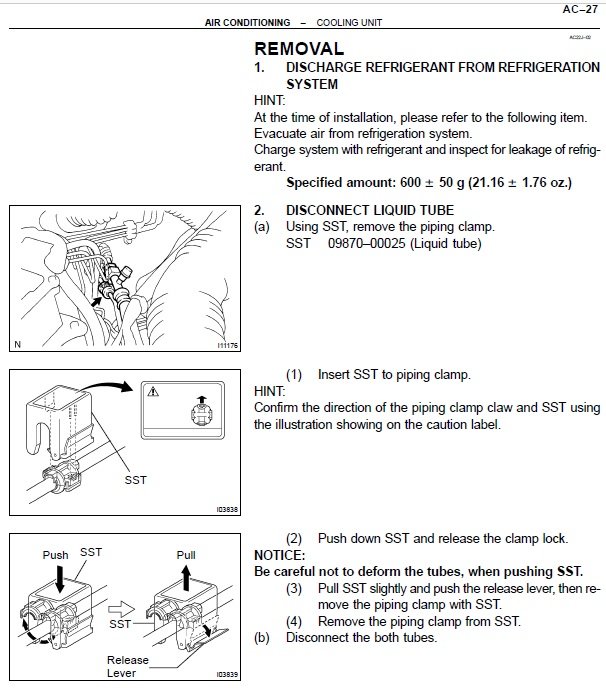

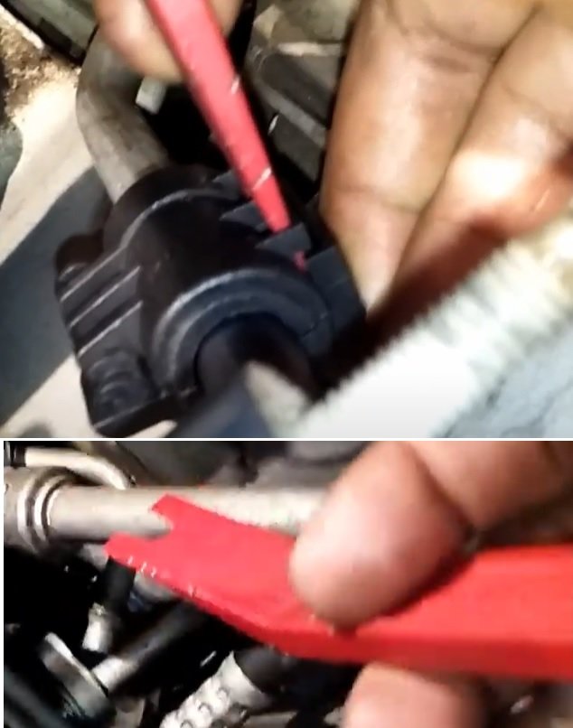

    This fellow used what I'm used to using when doing trim removal....a trim tool. It's a long way around the barn video but starting at 1:50 mark, he shows how he did it. It somewhat mimics what the FSM shows using their Toyo SST tool.
    and another shorter one....

    here you go, I just changed that line like a week or two ago, those clips suck. I will add that I don't know which clip yours looks like but if its the one in the picture I shared you need to press down into that tiny hole pretty firmly, doing that will depress the metal tab inside and allow the clip to open up. I tried not to move the airbox out of the way for the longest but it really was worth it to have the extra space in there.
