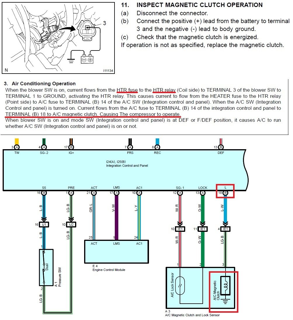

    Hey everyone, thanks for all your help recently. New problem, A/C lights blinking… everything I find say replace MG C relay. Magnetic Clutch relay. I have nothing named that way in any fuse box. Can anyone point me in the right direction?

    Much appreciated, I’ll look into it this afternoon. Just very strange no relay marked MGC for A/C clutch

    MG(Magnetic) C(clutch)
    Whatever literature you're referencing is possibly referring to your 05 DC Magnetic Clutch itself. There is a HTR relay(Eng Bay) and 10A HTR fuse(Cab fuse panel) that are needed to make the A/C magnetic clutch to operate compressor.

    Thanks Bubba, I’ve checked both the heater relay and a/c fuse. Both are good. I will check clutch via plug terminals tomorrow. I really appreciate your response
