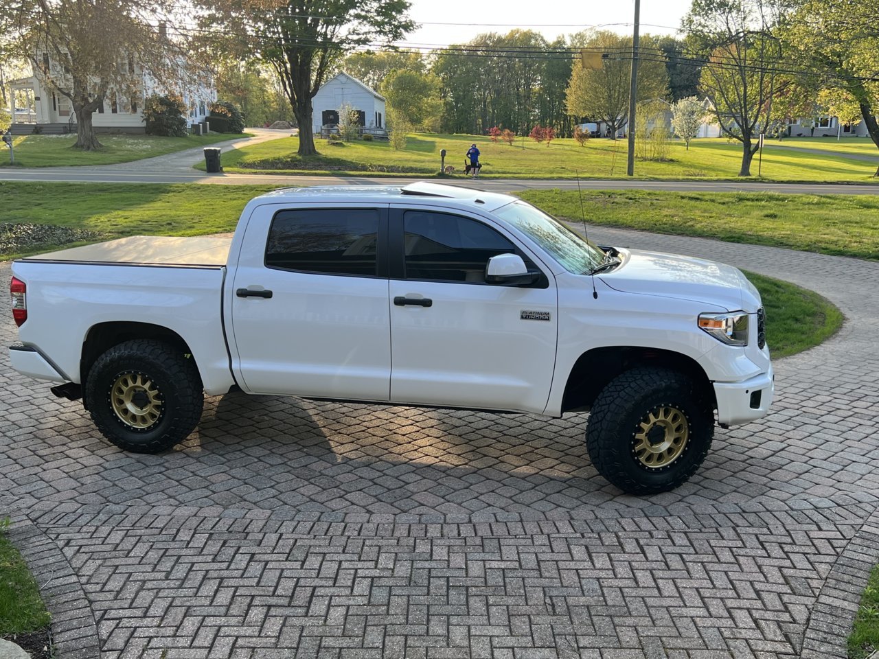

    2018 with 48k miles. Also appears to be leaking refrigerant oil onto my skid plate. Anyone else have their AC fail with such low mileage. Goes in tomorrow.

    Hopefully covered under your extended warranty (it should).
    On a side note, really like the look of your platinum. Those Methods look great.
