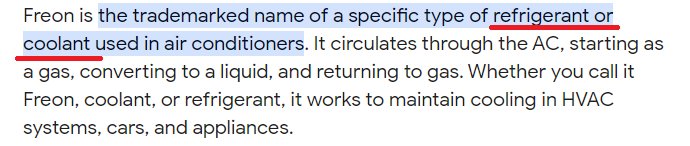

    And our trucks don't take "Freon". Freon is a trademarked name for other coolants. I believe our trucks take 143a, which is Trifluoroethane.

    134-a

    That's one way to highlight a dude's dyslexia :rofl:
