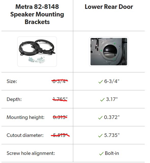

    Some fitment specs to start considering:
    Front doors. Ignore the Scosche specs.
    Rear Doors:

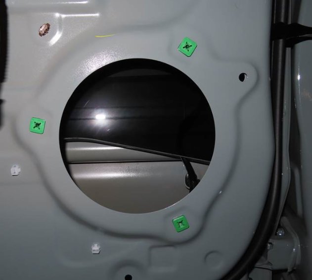

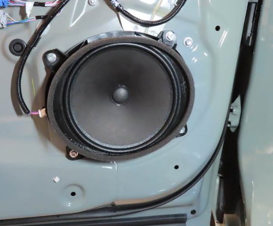

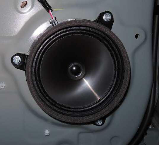

    The front speakers are not a 6x9, they are a ~6.75 and look like this:
    As you can see, the openings are still large enough to fit some 8's depending on mounting depth. TT lists that with their 1" adapters, max top mount depth is ~2.95". The Memphis SRXP82V2 list a top mount depth of 2.85" so those should theoretically fit, but the
    Memphis Audio MJP8's list a top mount depth of 3.25" so those would theoretically not fit unless you add an additional spacer (which depending on excursion of driver etc. might hit back of door card, or you space out the window track.

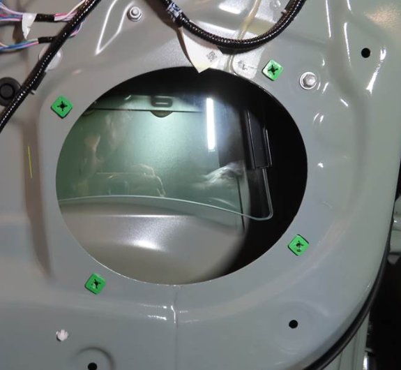

    As for the rear doors, they are a ~6.5" and look like this:
    The rear doors have a smaller cutout making fitment of an 8" driver more difficult/likely requiring trimming of the doors sheet metal to widen the opening.

    For "cheap" fronts and rears, you've got these included with speakers if you buy through Crutchfield, as well as the wiring harnesses if you use the factory wiring:
    $12.99 a pair for the front, allow install of a 6.5" or 6.75": Scosche SAT69 Speaker Mounting Brackets Install 6-1/2" or 6-3/4" speakers in select 2002-up Lexus, Scion, and Toyota vehicles at Crutchfield
    $19.99 a pair for the front, allow install of a 6.5" or 6.75": Metra 82-8148 Speaker Mounting Brackets Install 5-1/4", 6-1/2" or 6-3/4" speakers in select 2000-up Lexus, Scion, Toyota, and Pontiac vehicles at Crutchfield
    The wiring harnesses according to Crutchfield are the Metra 72-8109 for $12.99 a pair (again, included for free if you buy speakers from Crutchfield): Metra 72-8109 Speaker Wiring Adapters Work with select 2018-up Toyota vehicles — connect new speakers to the factory wiring plugs at Crutchfield
