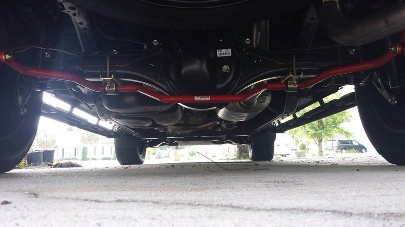

  4. Jul 29, 2015 at 7:03 PM
    George14
    George14 New Member
    Jul 30, 2014
    #527
    387
    George
    West Virginia
    2014 Tundra SR5 Dc TRD Off Road 5.7L with tow package
    None
    It is a bar that hooks to fram and axel. I got 2014 TRD with tow has the sway bar pull a 7400 lbs TT pulls no trouble at all post picture tomorrowImage from here's a link to a picture I googled 019_cc26538c58b13fb06fbcd5d1090606079109a88c.jpg.

    TRD sway bar. Very happy with it.
    stujaspermma likes this.
