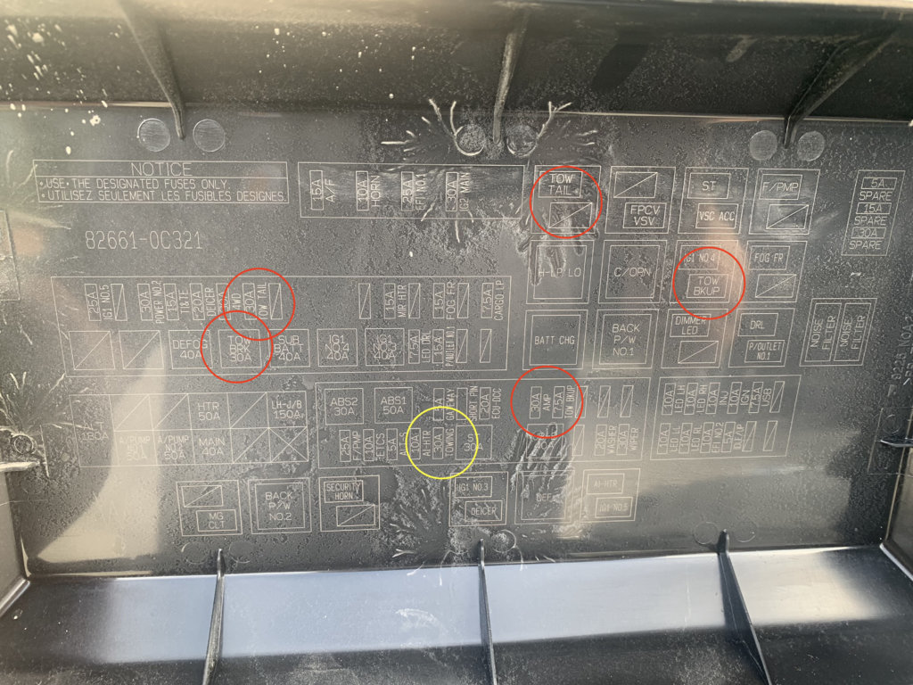

    There are a few. Please see the pic that I posted. Your fuse box lid will have the correct sizes listed.

    Yes, I would check all of the fuses and probably just replace the 30 Amp trailer fuse I circled in yellow. Then, using your multimeter set to DC voltage (dashed and dotted line, not wavy line), start at the plug at the rear of the vehicle and identify the correct pins for power, tail lamps, blinkers, etc. If you start with tail lamps, for example, you can verify that your multimeter is working correctly and that you have it grounded properly. Work your way up the line to each connector to trace where you do or don’t have power for the pin in question.

    Your diagram is different then mine
    I checked the 30A. And all the other fuses just don’t know how to check the relays
