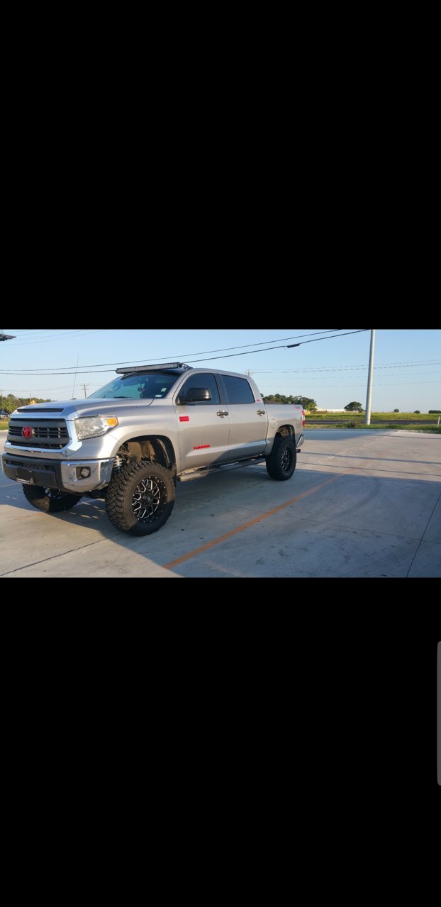

    Just installed my 7" lift with 35x12.5x20 and about 200 miles later I started hearing a grinding noise coming from front passenger tire and a loud knocking noise when taking off. Any clue what it could be?

    Front mud flaps have already been cut due to rubbing at install. A shop installed.
