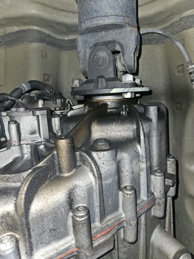

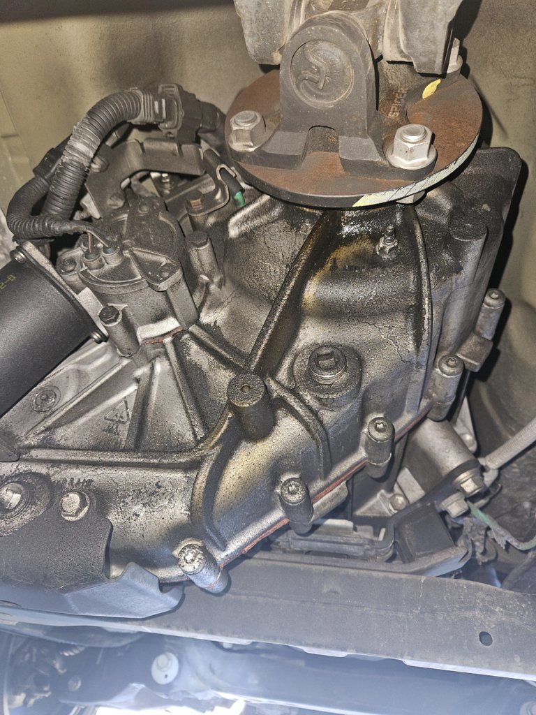

    Finally got time to get under and see if anything sticks out. This is the only thing I found. Went under the entire bottom, under hood, through fender walls. Idn if this would be cause a whine noise. Obviously seems I need to replace but is it anything to be super concern atm. Sorry I'm not mechanic nor I pretend to be. I know my limits lol
