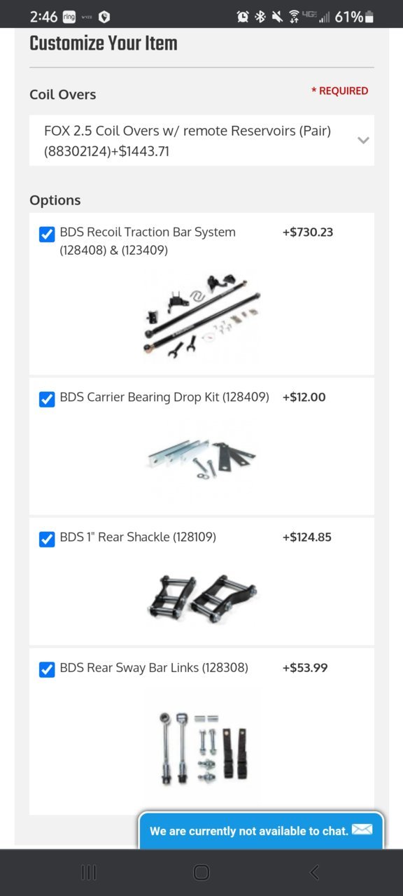

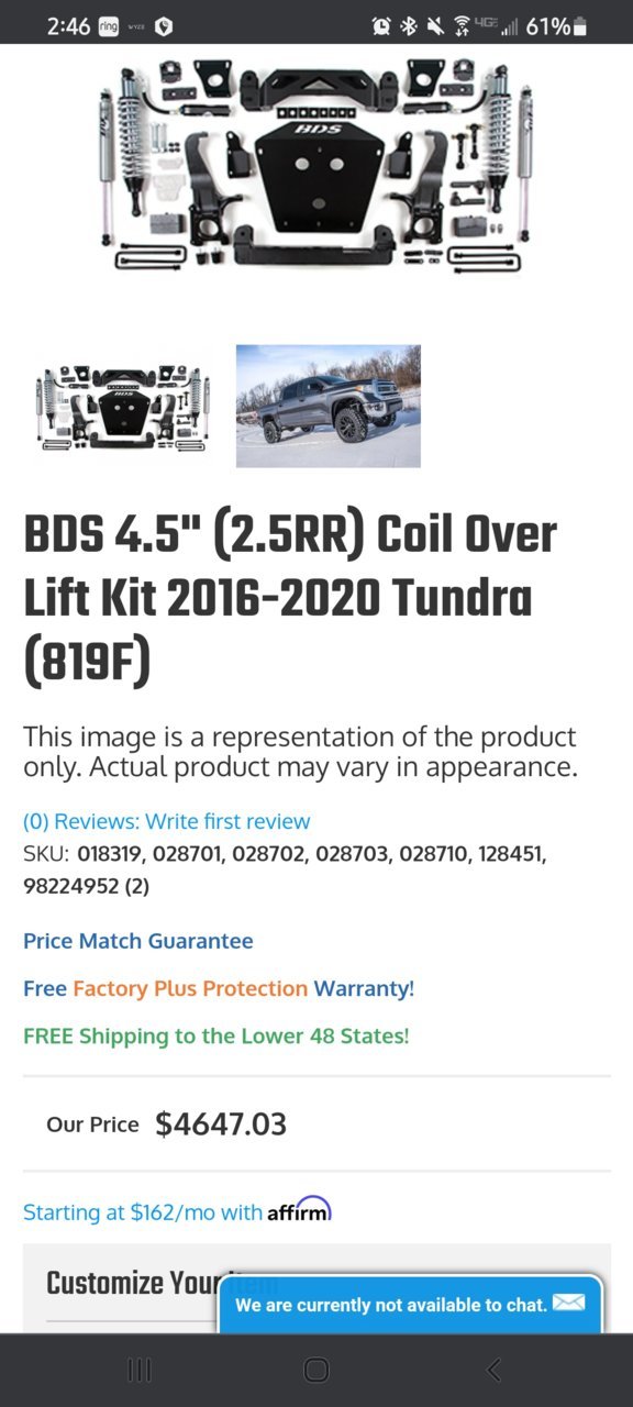

    Since this thread is up here. This is the setup I'm looking at getting. Anything wrong with it?
    The only reason I went with 4.5 is to get the fox shocks. I don't know much about larger lifts but if it's possible to get fox or icon shocks on a 6" lift then I would like to go that route. My runner could only go 3" higher so it was simpler to lift.

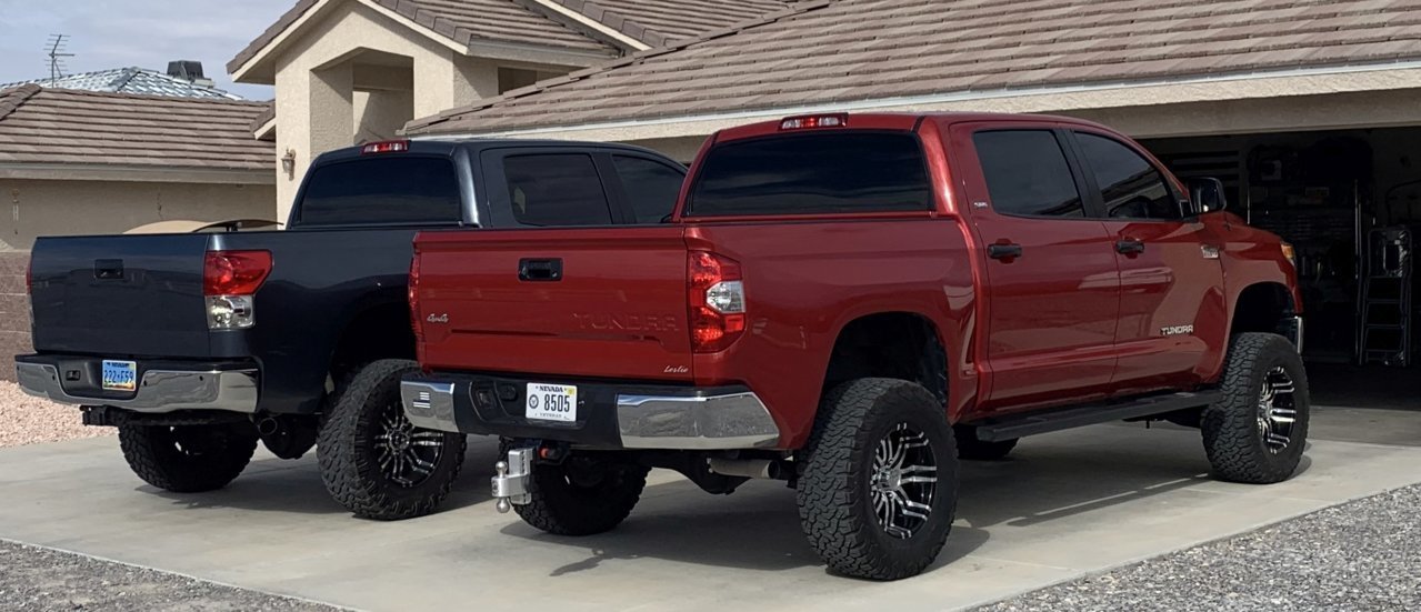

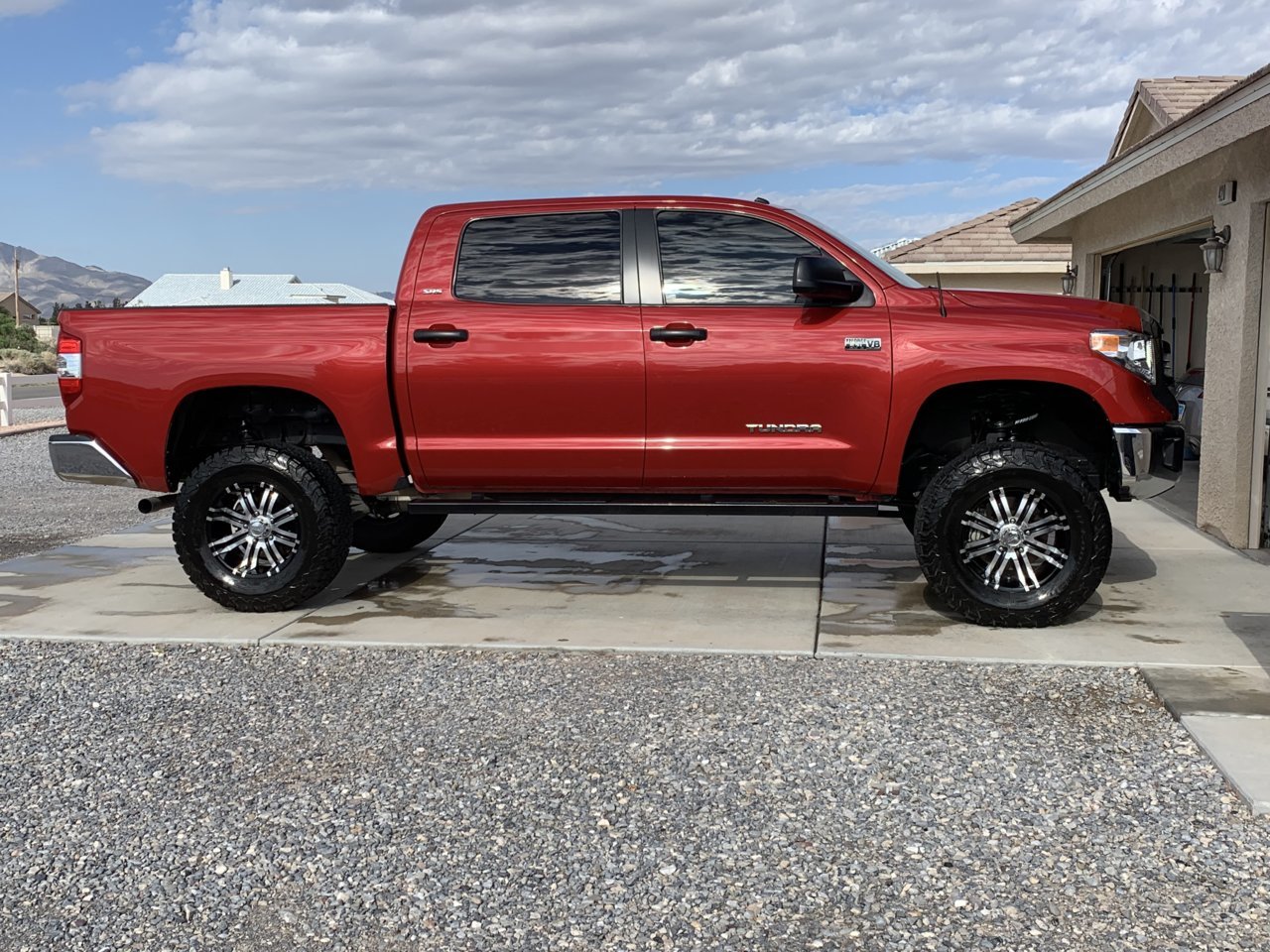

    Be advised, That installing a 6 or 7 inch lift on your Tundra will probably change you as a person and your truck will never ride the same. Lol, good luck

    I can't fit in the garage anymore either. The only part that sucks lol

    Lol I got lucky, I can still fit in the garage, 1/2 inch to spare.
