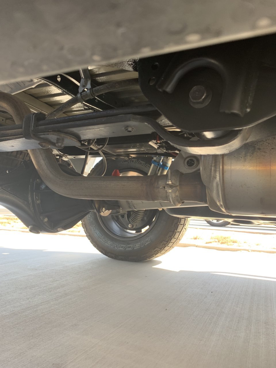

    You can pickup stock leaf pack from someone who removed theres for pretty cheap. Yours looks to be modified by that last leaf though

    2007+ leafs will work. No difference between truck trims on the leaf springs. Just shocks are different on TRD based trucks.

    Should work no problem. Spring rates from my knowledge, are all the same for the leaves/years/trim.

    This is a stock leaf pack. You're missing one leaf so your current leaf pack has be modified.

    Yeah, looks to me like you are missing one.

    They will work just fine. If the original leaf pack had 5 springs and was oem, toyota changed speca to 4 for cost savings or it was due to the adoption of sae j2807 that happened in 13 or 14(?) And lowerd payload ratings across the board. The chassis is the same from an '07.

    That goes towards the front. And confirmed my truck has only four layers instead of five like yours. But it should bolt right in. This will be the first I’ve heard of it not working. Seems like quite a few guys around here have bought newer springs and installed them on there 07 to 13

    2012 CM with a 4 leaf pack (3+ overload).

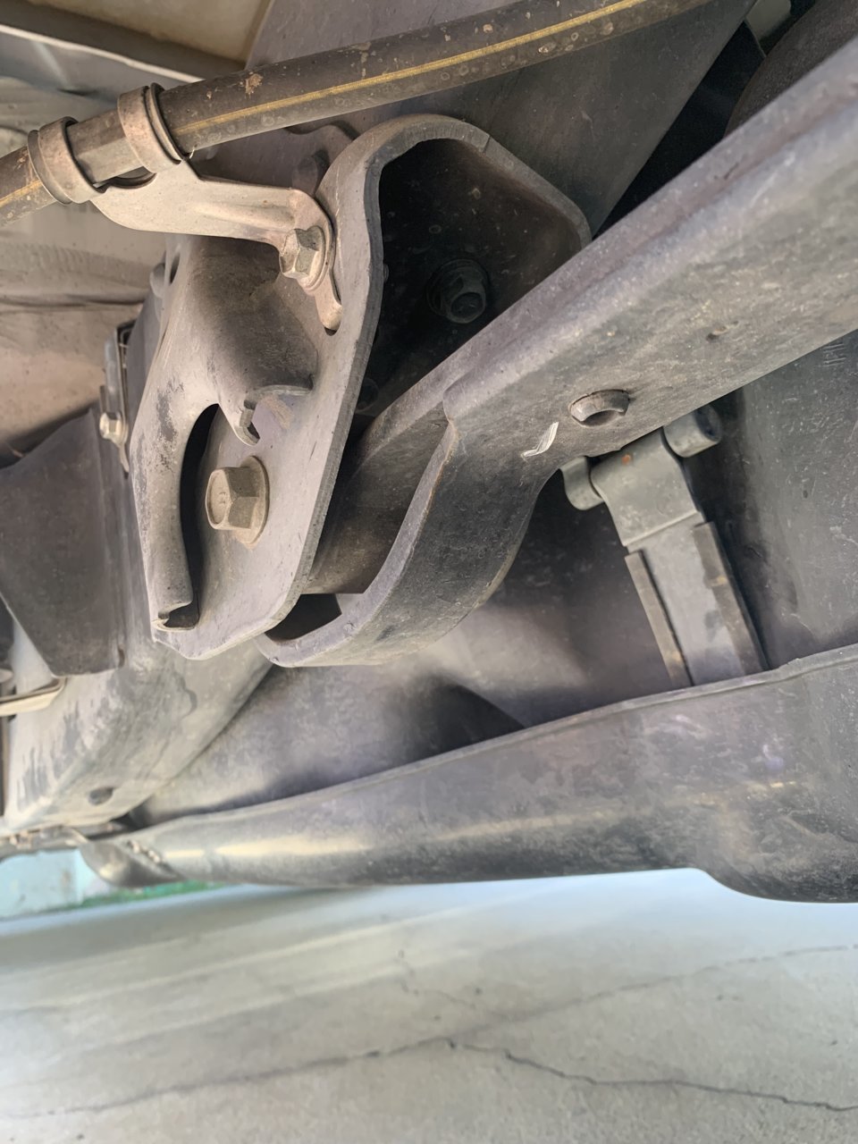

    That is called a shackle. They are replaceable, they can be stock height or provide lift depending on what you buy.

    Lots of guys here just got some new coach builder shackles. Maybe someone in your area has their old set. If you can wait two weeks (going out of country) I’ll send you mine for free.

    Do the new shackles come w the bushing in tact? If so you can probably cut that lower bolt off and just go buy a bolt

    Worst case, grab a sawzall and cut that thing out.

    Dremel and a cut off wheel. Or ten cut off wheels. Cut the leaf, and then the bushing. I’d hit it from two sides with the cutting disc so it will easily come apart.
    Seriously, it’ll be easy. Don’t stress. Sleep on it, cut it out in the morning. Although I personally would soak it with PB blaster tonight, lay it on its side under your truck, put a couple concrete blocks under it to shim it, put my bottle jack under the truck with one side pressing on seized shackle bolt, other side against frame and use it as a press to push it out. (Or put it in a press but I don’t have one.)
