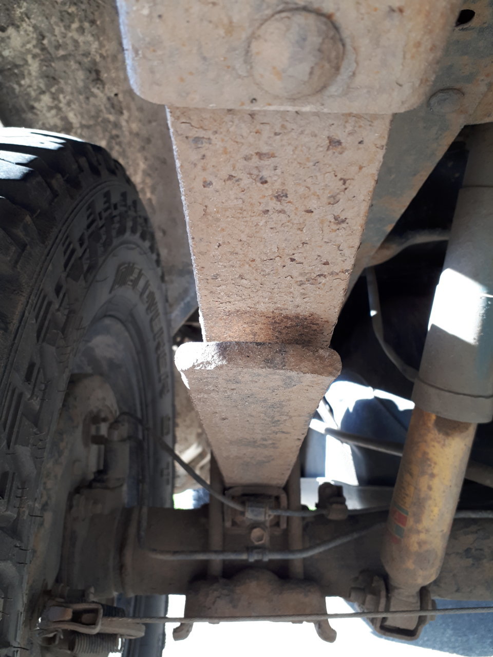

    Good to hear. I'm going to go out right now and check my leafs. I seem to remember them being a bit splayed. Pics to follow. LOL

    They look ok except the back of the driver's side. Do I just put a u-bolt over these told get them back into place?

    Yeah. My advice is square the leafs and u-bolt them first, and then do the shocks and lower ball joint. You may not need the tie rods, but if you do them do them before your alignment.
    If you do u-bolt the leafs do not tighten the clamps all the way down like I did as it seemed to keep the leafs from spreading length wise and gave it a rough ride. I loosened them up and the ride got better. Cut the extra length off the long bolts threads and then put a notch cut up the bolt so the nut will not come off. Also, used some flexible adhesive on the top of the u-joint to hold it in place on the leaf and keep from sliding down the leaf. The bottom of the clamp is not caulked and allows the leafs to stretch and slide on each other.
  6. Aug 4, 2018 at 5:48 PM
    Professional Hand Model
    #14878
    14,993
    Fred
    Hand Protectors
    My passenger side was slightly splayed and the u-bolt was still able to bridge over the difference on the ends where I wanted them. Drivers side I had to jack up the chasis and play the leverage game while using homemade clamps out of metal plates on straight bolts on each end. Tightened each end a bit at a time alternating with each movement of leaf. Slow, but it worked. Got it to where the u-joint would fit like the passenger side did with ease.
