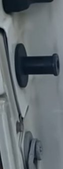

    29,573
    Try wrapping electrical tape around this on both sides maybe 2 layers.
    Then spray a lubricant in the latch on both sides.
    If not this I'm going with shackle bushings.
