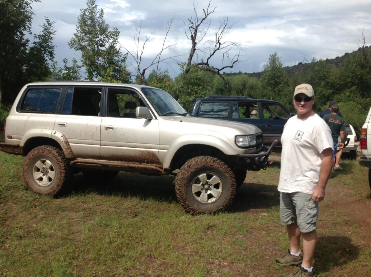

    Mind sharing pics of the LC if you have any? 80 series?

    Here is one I found, I have tons of pics but sold it 5 years ago
