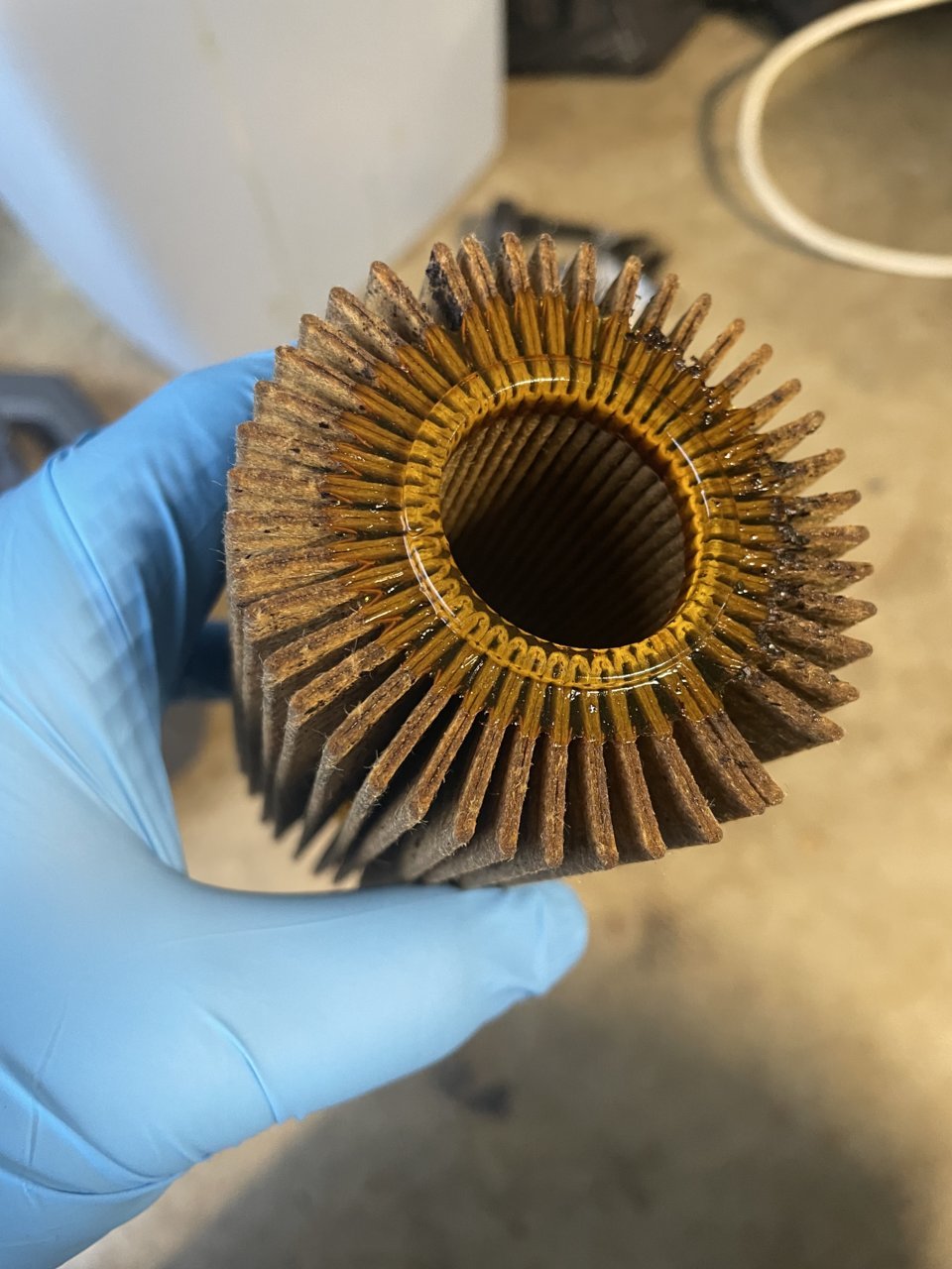

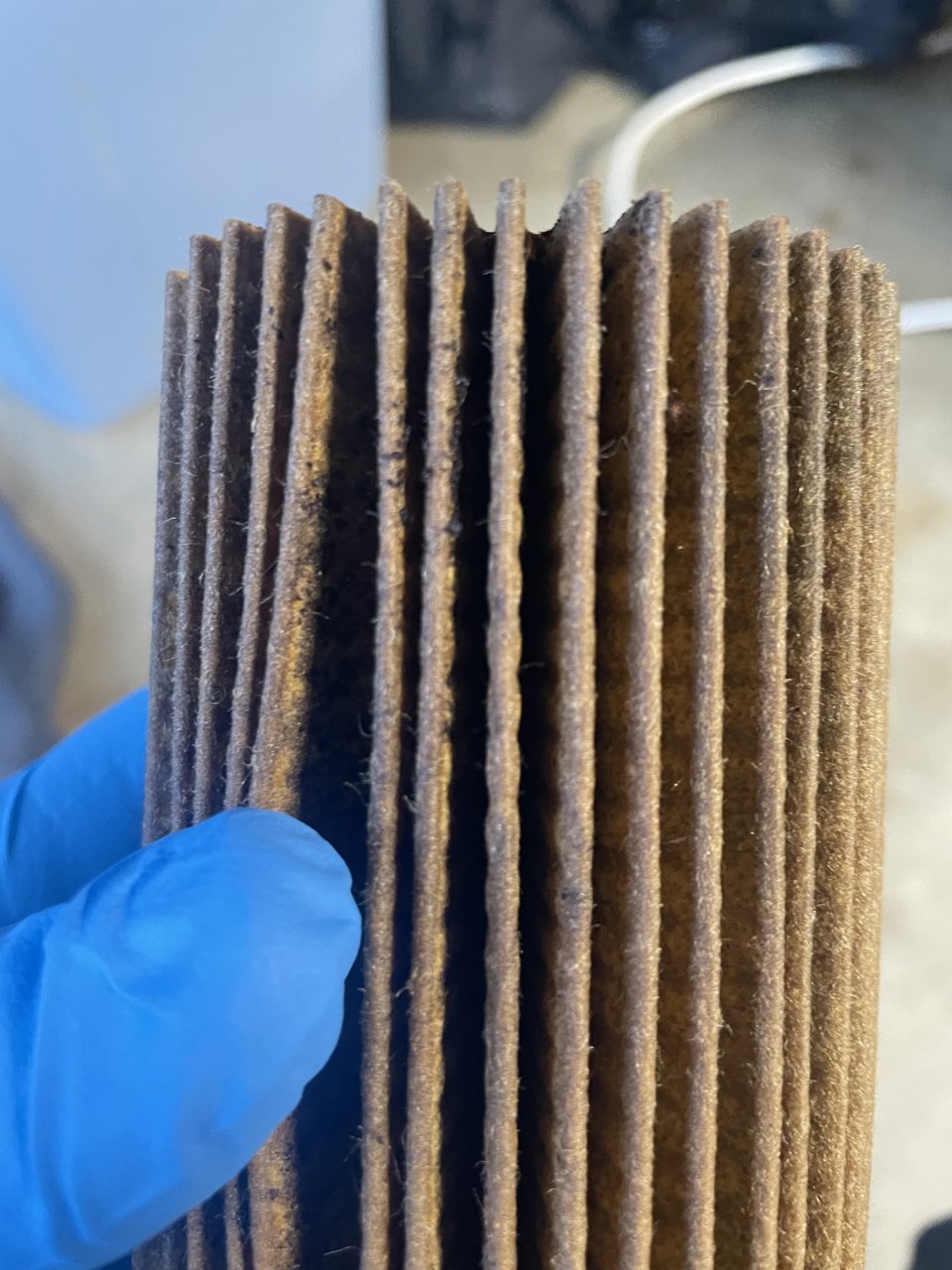

    Strange question, I know. Just curious. It was supposedly changed 1k miles ago. The filter looks degraded to me. I’m suspecting that this was not changed for a very long time. 150k miles on the engine.
    It seems to me like they didn’t change the filter when they last changed the oil. Maybe it has been two changes since the filter was changed?
    EDIT: one more bit of info – the drain plug was torqued down so hard on the filter housing that I had to use a breaker bar to loosen it. I was able to remove the entire filter housing just by turning the drain plug. Completely ridiculous.

    if I had to guess, filter was changed but previous OCIs may have been long!

    possible it wasn't changed last oil change. is it oem Toyota filter or aftermarket ?

    Looks aftermarket to me. Done by an independent local shop. A friend thinks he was ripped off.
    To me, it looks like there’s no way this filter only has 1000 miles on it, which is when the shop says it was last changed.

    I just changed my oil and filter on Friday. I used an OEM filter and the glue used on the top was not clear like in your picture. I was a foggy white. I would assume aftermarket…but I could be completely wrong.
    Additionally, my filter had 4k miles and didn’t have those small clumps on the edges.

    Yeah I don’t think the one I posted pics of is OEM. OEM filters have the part number on one end. The one in my OP also looks like it has been in there forever. I’ve never seen an oil filter so frayed and filled with dirt and sediment.

    Seems pretty common for oil techs to over tighten the filter housing cap... Then the next guy breaks a few tabs off the plastic cap, and says "fuck it, they'll never know I charged to replace a filter I didn't. I mean, I DID TRY."
    My filter looked pretty yucky upon the first oil change of my ownership, and the oil that came out looked like it could have been poured from a sealed bottle, so I know it had JUST been changed. The filter cap was so shredded, and it took quite the go with one of my beefier impact drivers to finally come loose. Replaced the cap with the aluminum version and perform my own changes, so there have not been any further issues.
