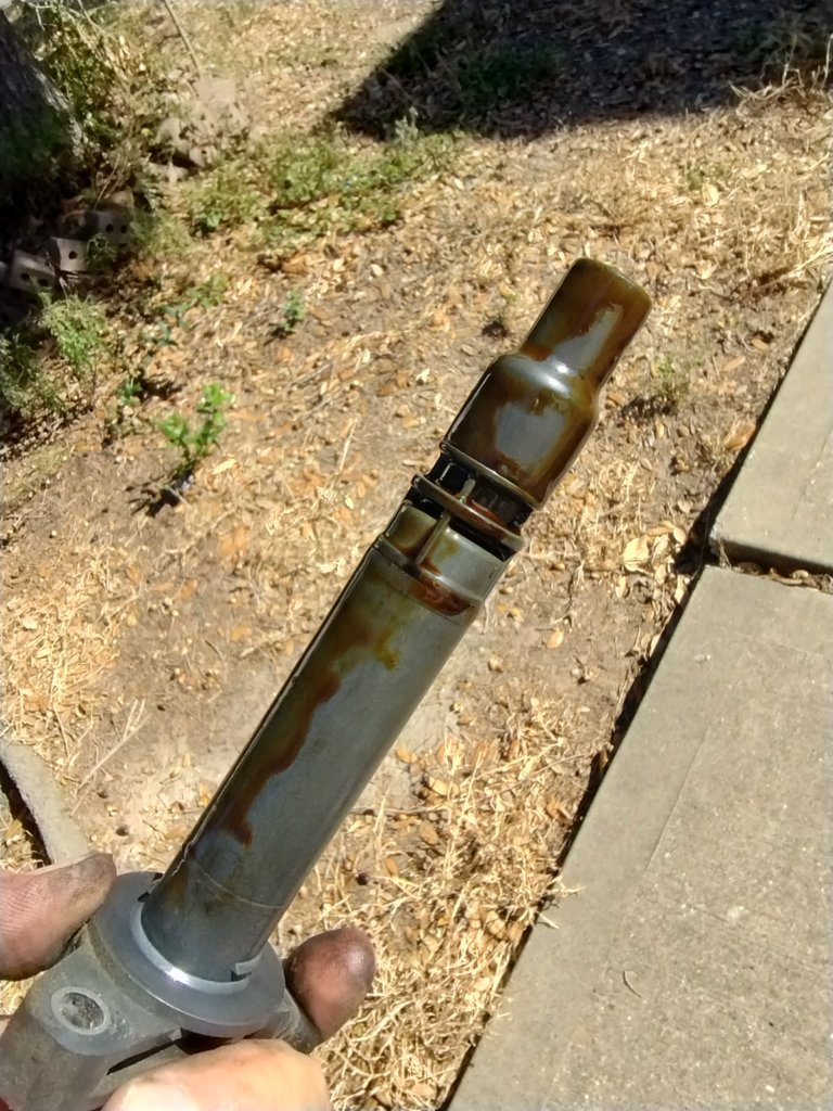

    I've had it 15 months no apparent issue drives just fine imo every day....I had never pulled a spark plug for inspection till today. Both boot and spark plug were soaked in motor oil.
    Trying to establish what if any action to take.
    Pros: No check engine light/ codes, does not leak any oil externaly along the heads / visually dry heads & pan no oil puddle. Does not consume any oil between 5k oil changes, starts up first crank, smooth engine, has insane amount of power imo...
    ( My last truck was a 2.7 Taco)
    Cons: oily spark plug & boot.
    For 239k miles is this typical or a upper head gasket issue.
    Presuming it was a worn piston ring wouldn't it have symptoms ? CEL
    Also...can't a compression test establish if there is a piston ring leak ?
    I'm not in any way a auto mechanic.
    What are other possible causes ?
    Could it be It simply has to much oil in the crankcase ??? Idk.
    Genius me. No picture of spark plug..duuuuuuh.IMG_20241008_153236039_HDR.jpg

    You'll need to replace the valve cover seal for plug tube. It's leaking causing oil to accumulate on top of the plug and seeping down. A few instances of the plug tube not seated fully. Easy to change a seal out though.

    Clean the motor up good. Drive it for a bit and look for wherever you see leaks. 5.7 engines aren’t particularly leaky in general. Problem areas are cam tower leaks, valley plate leaks and like most vehicles, darn valve cover leaks. Spark plug tubes are in the center of the valve covers and use an o ring type gasket to seal around the tube, which is part of the head. Piston rings are not the issue here.

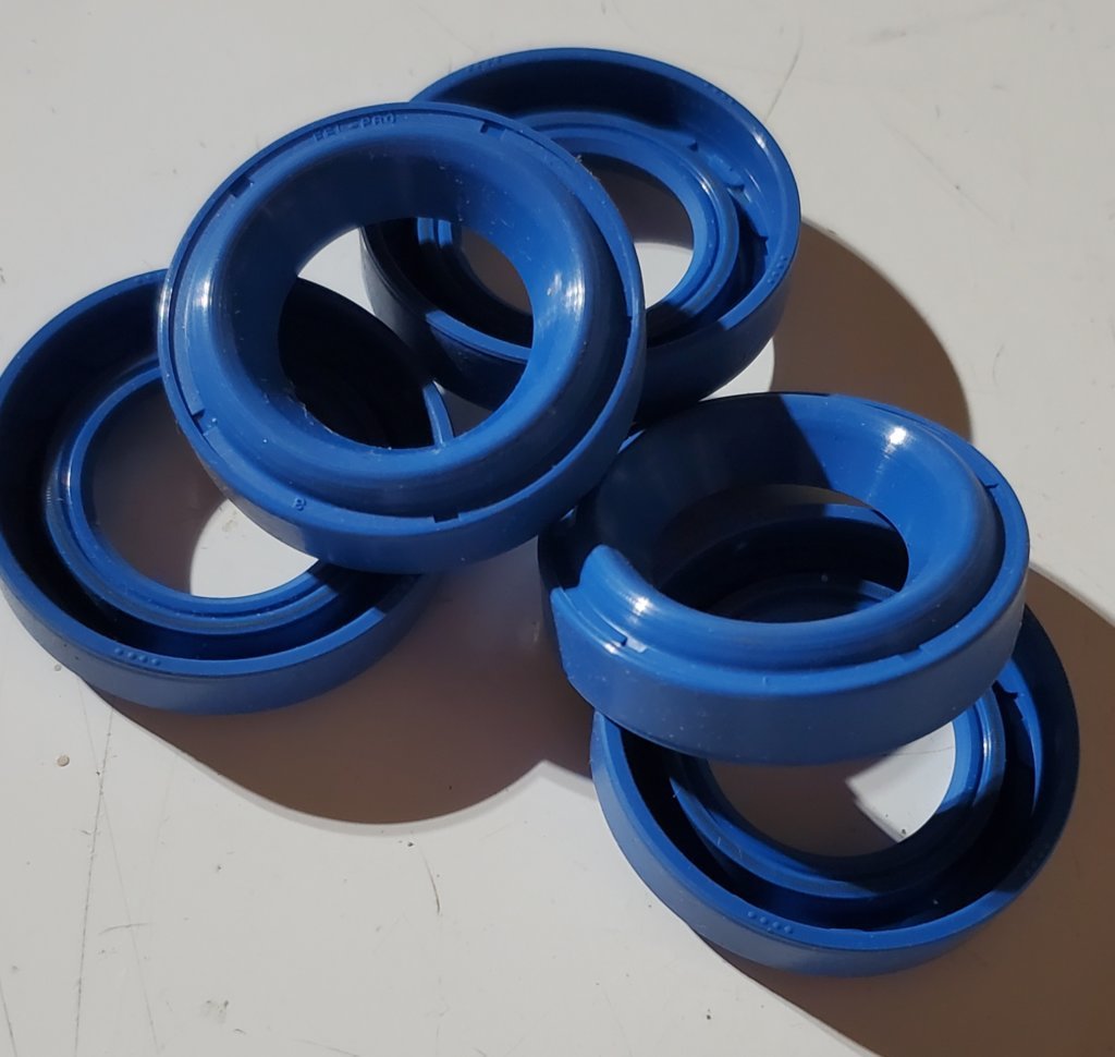

    I found a image of the tube gaskets I see how their installed.
    What's the worst thing that can happen if I leave it alone ??

    So
    Rite on
