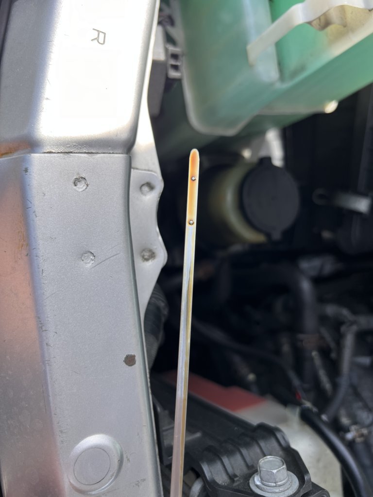

    I did an oil and filter change on my 2011 5.7 this week and I noticed something odd. I added 7 quarts, started and ran it for a few minutes, then turned it off and added one more quart - so 8 quarts of new oil added. This is the capacity - right? But the dipstick shows it at the very low end of the full range; like I should add at least another 3/4 of a quart to get it to the full mark.
    Is the dipstick correct or is something awry with it? I don't want to overfill the engine.

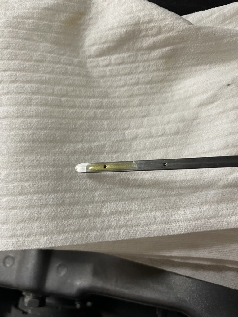

    I just did an oil change Sunday and this is what 8 quarts gets me.

    looks like you can use another half quart to be to the full line

    Unless these are different than the other 2 Toyotas we've had it's 1/2 quart from the bottom mark to the top mark on the dipstick so you'd be about ¼ quart low.

    7.9 quarts with the filter is in the manual, I put in 8? Does the dipstick supersede the manual? I’m between the two dimples so everything should be fine.

    As long as it is at the lower dot, on both sides of the dipstick, you are at operating level. If you aren't burning or leaking oil then the lower dot is just fine.
