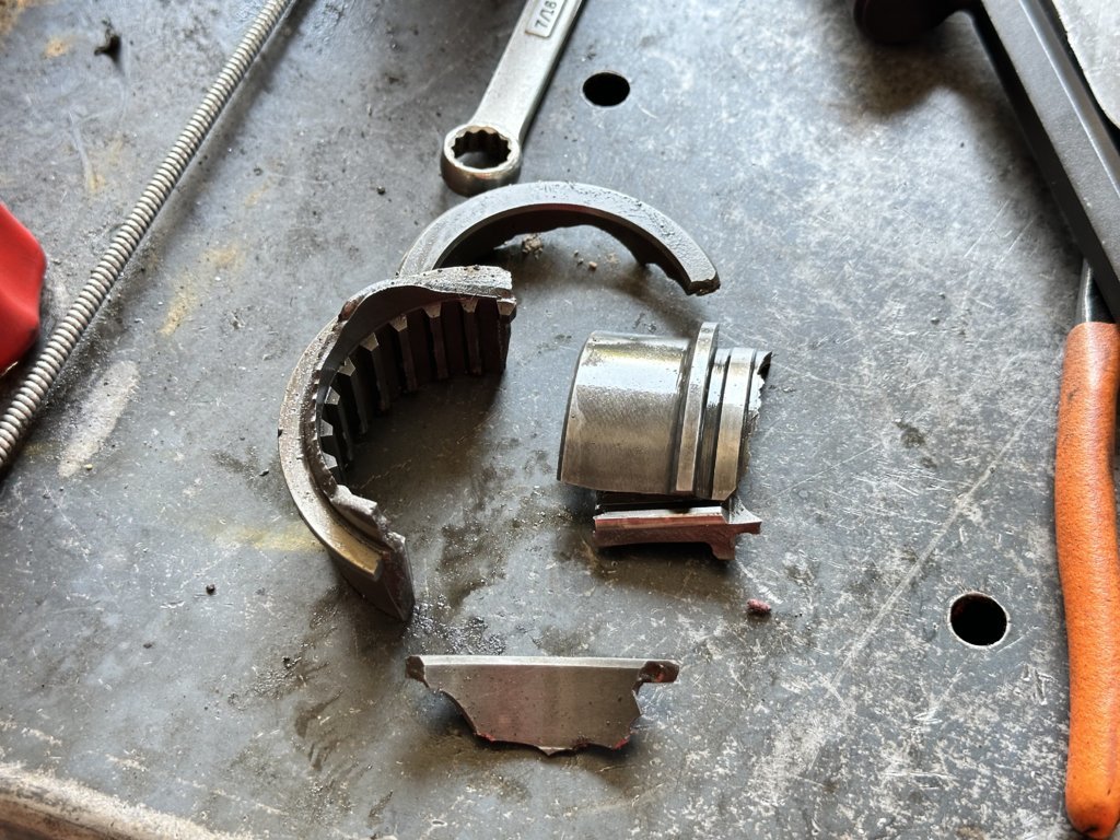

    I experienced something similar. I’m also S/C’d and have done plenty of 4H launches, with no problem. Except when there was a problem…
    I didn’t realize 4H hadn’t completely engaged when giving it the beans. Grenaded the differential clutch sleeve

    Did it do any more damage? Or did you just swap out a full used diff?

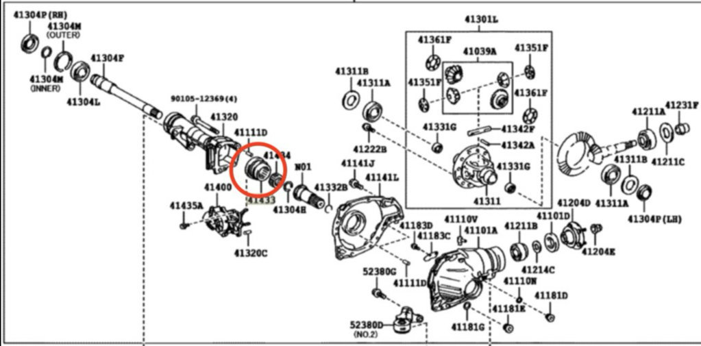

    Fortunately, it was a much easier - and cheaper - fix. Removing the ADD actuator served as an observation window. To replace the sleeve required removing the right axle housing from the diff. Best part about it is the diff stays intact and mounted in the truck.
    Edit:
    No more damage was found. The diff housing has a small weep hole (essentially) to allow fluid in/out. There was no debris found in the diff, so I just replaced the fluid and it's been fine.

    Awesome, I was hoping that was the case and it didn't yeet through the actual ADD housing portion of the diff.
