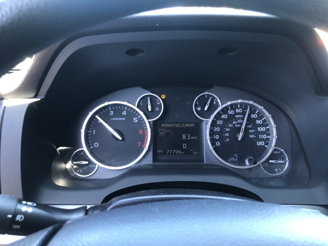

    Just took my dogs for a walk and my truck on the freeway for ya. I have 5.29s and 37” KM3s. These specs were at minimal throttle(not punching it). Hope that helps. I recalibrated my speedo to be correct with the hypertech speedo calibrator. Used two gps systems to make sure it was as accurate as possible and about 10 different runs since you have to tell the software what tires you have and the gears you have. Mine thinks it’s on 44s to be accurate. Had the wife take a pic at 70. Don’t mind the mpg average. I just got my truck back and had to reset it. I usually stay at around 10 city and 14-16 highway.
    70mph at 2000rpm
    80mph at 2500rpm

    Now we’re getting somewhere I appreciate it! I assume you weren’t cruising 90 for a while but how did it feel getting up to that speed I know you weren’t punching it but have seen some members post about them losing overtaking speed on the highway with gears. Thanks again really appreciate the concrete evidence from everybody posting here!

    Getting up to speed feels effortless compared to my 35s on stock gears. Never had 37s on stock gears. I live in the Bay Area, we have lots of big hills to go up and the truck does it will little throttle. As for overtaking people in the truck when I actually get on it, it hauls ass and never have an issue passing people if I choose to. I tend to cruise cause these tires were not meant for speed and are not cheap. The tires are only rated for 100mph and I don’t like pushing it as if I were to lose traction at 100 with my heavy bitch I could easily kill several people by splitting a small car in two. Juice is not worth the squeeze and it’s not a race truck.

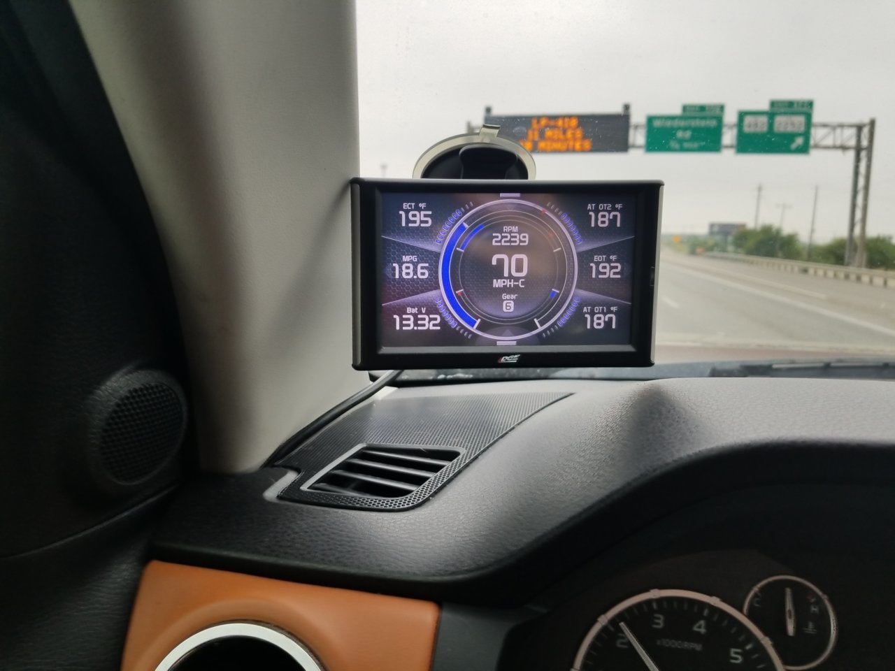

    Here is a photo of all the fluid temps after driving on the highway for 40 minutes over the weekend.
    Engine coolant upper left
    Trans temps - upper & lower right
    Engine oil temp - middle right
