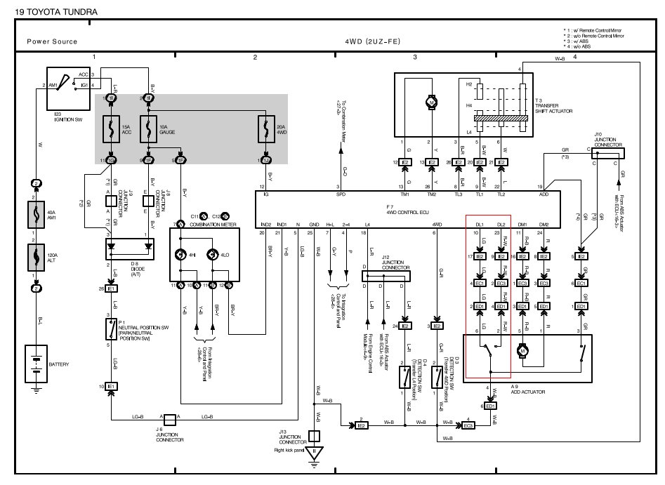

    I tested the voltage from the ECU to see if maybe the red-white wire wasn't putting enough voltage through to be able to shift the actuator into 4WD. I found that both the red-white wire and the light green wire (pins 2 and 6) get power when I disengage the 4WD button but neither of them get any kind of power when I engage the 4WD button. This leads me to believe that the 4WD ECU is bad and needs replacing. Am I on the right path?upload_2023-11-28_6-25-25.png

    That makes sense in my head, but be warned: I purchased a new 4WD ECU and it didn't solve my issue. I didn't test nearly as in depth as you have, but when pressing the 4WD button I heard 5-8 repeated clicks from the relays in the ECU. This seemed off to me, but the new-used $110 ECU did the exact same thing. Can you hear your relays click when you press the button?
    It definitely seems like the ECU is being commanded to shift, I'd be surprised if the issue was related to the switch or the wiring between it and the ECU. Just thinking aloud here, but could the wires between the ECU and the position switches have a break? Have you looked at the FSM? I know there's a procedure to test the transfer case switches but I'm not sure bout the ADD.
