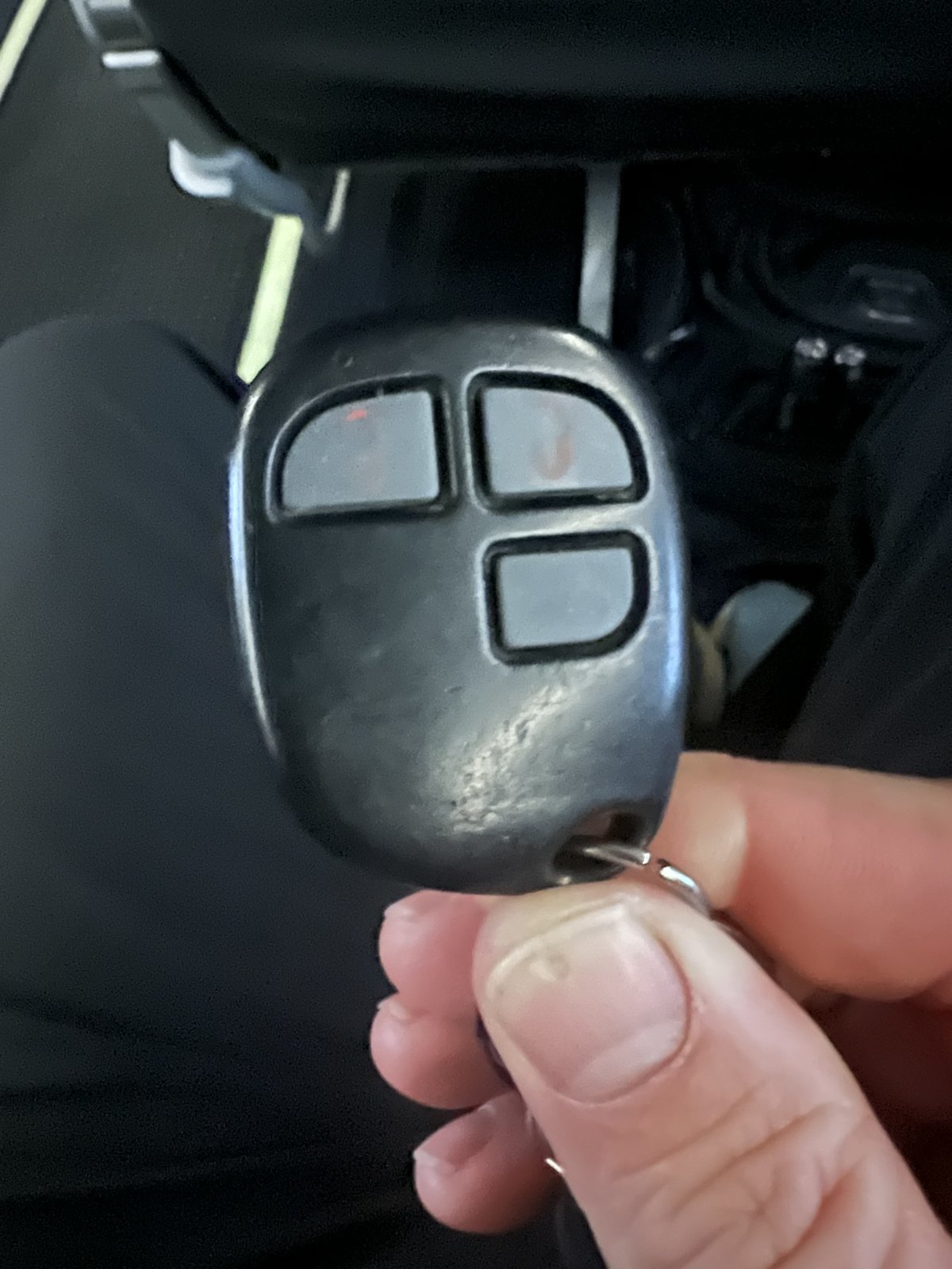

    Don’t believe there is an OEM for the 2000 Tundra. Maybe the RS3000 stuff which I guess they used as the OEM. I just got some crappy no name keyless with two remotes. Has an LED indicator I mounted in the gauge bezel surround so it’s visible from the drivers window. Wired the parking lights to blink when you lock and unlock. It’s actually capable of more, just have to add the relays to the output channels. One of the best bang for the buck mods I’ve ever done on the truck. Never a hiccup with it.

  25. Oct 12, 2023 at 5:29 AM
    #25
    shifty`
    shifty` In South Dakota Trouble ain't hard to find
    Jun 20, 2020
    #48239
    28,559
    ATL
    '06 AC Limited V8/4WD

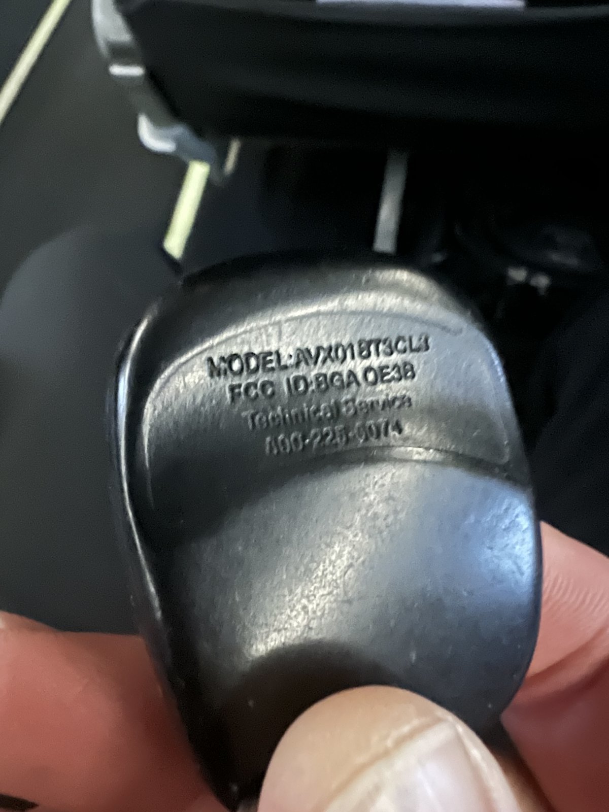

    Shocking, but good info. I’d be curious who the manuf’er is. I know you said it was generic crap, sometimes quality stuff got whiteboxed, and the only way to tell is checking the PCB for markings, the brain box for markings, or use the FCC ID on the fob to trace back to FCC’s doc submission. (Latter is usually pretty effective)

    Pics of the fob
  27. Oct 12, 2023 at 5:37 AM
    #27
    KNABORES
    KNABORES Sarcasm incoming
    Jan 1, 2020
    #40572
    13,845
    Arkansas
    Appears to be an AudioVox
  28. Oct 12, 2023 at 6:40 AM
    #28
    shifty`
    Jun 20, 2020
    #48239
    28,559
    ATL
    Audiovox has consistently gotten a lot of shit over the years, and while I used to talk a lot of smack about them bitd while flexing on other name brands, they've never put out shit quality (just had awful package designers). Stacked up against today's globalized penny-pinching market they churned out solid quality, and I'm not at all surprised you've had a good experience. They were always better than budget brands like Realistic or BOSS.
    Audiovox (now Voxx) bought Code Alarm not long after your truck was sold, Code Alarm puts out quality auto add-on products still today. Voxx has some pretty big names rolled under them at this point ... Pioneer, Audio Research, Klipsch, and I'm sure there's more. I don't recall what their relationship to Gentex is, but I know there is one, and Gentex is and has been the largest provider of OEM multi-function rearview mirrors for a couple of decades now.
    But you are getting near that 15yr mark that's pretty classic for units like that to fail, at least in the SE USA. PCB cracks/trace shorts, solder joint fails, cap fails (where used) being the bigguns.
