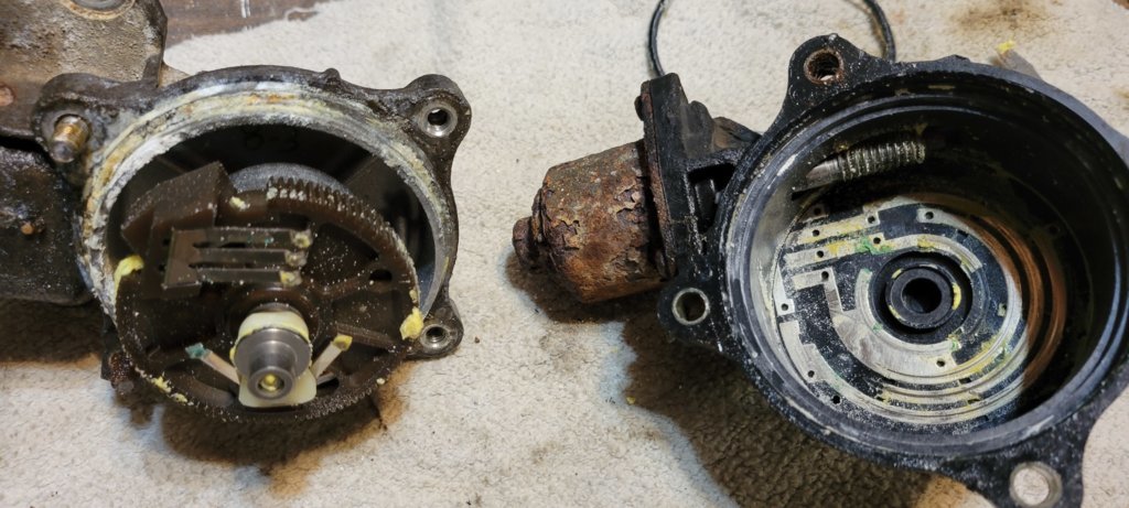

    Ya, I was trying to open the wrong actuator. I got the correct one open and a cup of water and mud came out, cleaned and greased the contacts and 4hi 4lo worked fine. Almost a year later I tried to engage 4hi and it wouldn't engage I got the blinking 4hi 4lo lights. Haven't had a chance to mess with it much but the lights continue to blink with the truck on and off over a couple days which I think is different then before. Before, with the 4wd switch turned off the lights would stop blinking with turning the truck off and back on.

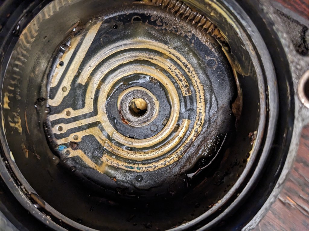

    Transfer case actuator cover before and after wiping it out, there was maybe 1/2 oz of water in it when I opened it up. Lubed it and reconnected it and disconnected battery before trying again, no change both 4hi and 4lo lights flashing.

    Has that outer contact ring worn away in the center or it that still grime on it there?

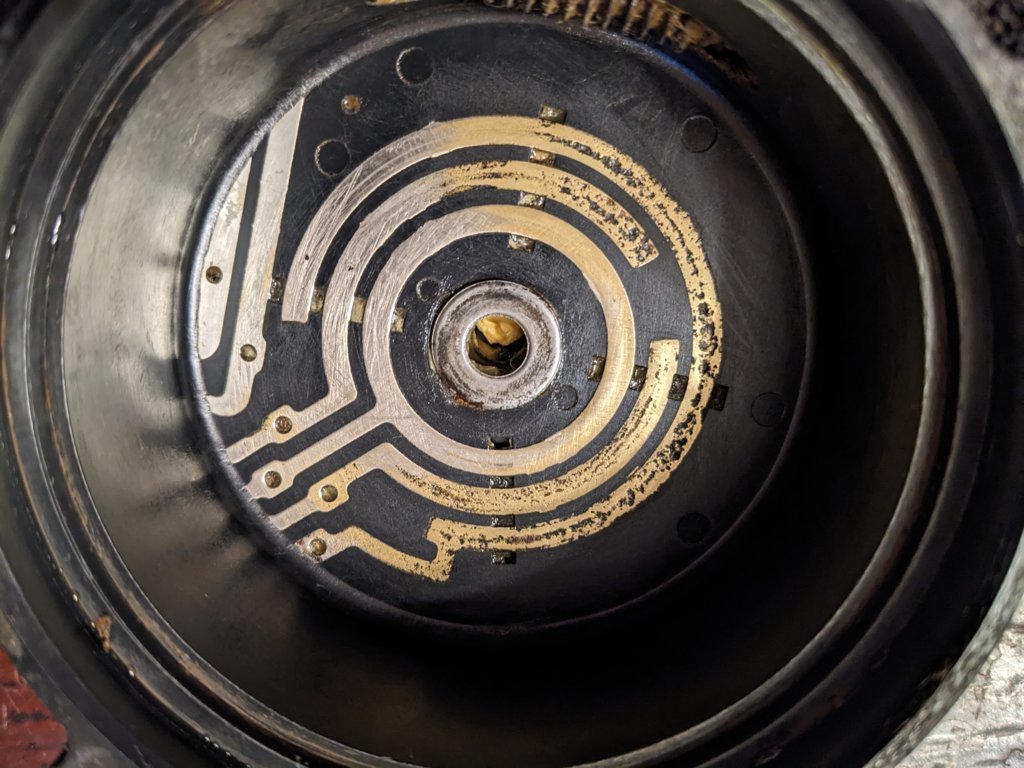

    Not sure what you mean, the black bits in the gold are pitted with corrosion eating at them, I took a bit of sandpaper to it but I didn't get anything to push into the pits and try to scrape them clean.

    Yeah, that’s what I meant. Thanks for clarifying.

    I wonder if there’s a legit way to fill the pits in the metal, refurbish it?
    I’d buy a new cap (or score one at a JY) just to be sure. I’d need to dig in EPC to see if you can buy an OEM cap separately. Or to get a part number and check to see if anyone makes an aftermarket.
    @StedeBonnet dis you check the two wire harnesses on the xfer case actuator to check for corroded/bent/broken pins, melted plastic etc?

    That outer trace is whasted, dang. And that doesn't look like the standard "lube" in there.
    I know you can solder to brass. If I was broke/or cheap, and have nothing to lose ide try to fill in those voids, sand-dremel it down and send it.
    But solder doesnt seem like it would be hard or last very long.
