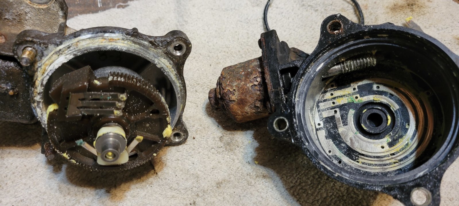

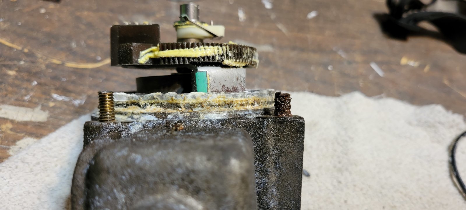

    Did your mechanic open up your transfer case to replace that actuator?
    I disassembled and serviced both my front diff, and transfer case actuators. The front diff is fairly simple. The transfer case though is another story. This is my understanding, you can do it two ways. split the transfer case and take the whole actuator out (with the shift rod) as one and replace it.
    Or do like I did and remove the small gear that locks it in place and remove just the actuator. Problem is after you clean up the traces and reassemble it you need to "clock" it perfectly or the truck may be in 2H, and the actuator in 4Lo/4Hi. I managed to get 4Hi to work, but not 4Lo.
    I sat and stared at that mechanism for a long time trying to decipher what I was doing wrong.... after 3-4 attempts I settled for 4Hi only. For now anyway.

    Yes, not bad at all. Thing is you can actuate it (just hanging there) and tell if its engaging or disengaging. If you parked in 2H, then set it disengaged and slap it on, and vise-versa.
    They do get crusty in there, green is bad :rofl:
