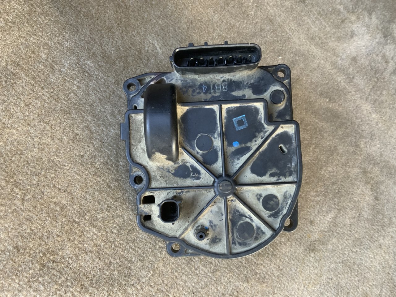

    Hello, new member and just bought my wife a 2008 Sequoia 5.7 4x4 with 180k miles and rust free for a bargain. The prior owner didn’t want to deal with the 4wd problem and after doing some research on here I though it should be a small enough issue that it is worth picking up and fixing. The previous owner said they were driving along in 2wd and the 4hi light just started flashing rapidly. Since then the transfer case shifter has been inoperable and they drove it as it was for a couple months with the display constantly flashing only 4hi. The cruise control doesn’t work which I hope is a related issue:fingerscrossed:
    So, I’ve read most of the transfer case actuator threads and was expecting to take the top cover of the actuator off and find a rusty motor but unfortunately that was not the case. Let me give a run down of what I have tried and fair warning that I’m a modest mechanic at best...
    1. Used a code reader and got no codes.
    2. Listened to the transfer case actuator as the switch was turned and heard nothing.
    3. Check all fuses, transfer case electrical connections and front diff electrical connections. I turned the ignition on, cab switch to 4hi and used a voltmeter on the lower transfer case connector and got a cycle of varying voltage on most of the points. I’m not sure if this is correct or if it should be a consistent voltage signal. Maybe it means the cab switch is bad or it is some sort of computer issue?
    4. Open up the top of the transfer case actuator. The vent hose was still in tact (although somewhat rotten) and it looked like new in there. I used a battery and alligator clips to attempt to move the motor and it turned freely in both directions. I then re assembled the actuator hopefully correctly and still no dice.
    I am beginning to think I am going to have to take a trip to the dealer or a more experienced mechanic to help diagnose this issue. I bought the rig for $7,500 so I have some room for repair funds but we all know keeping the repair fund down leaves more money for fuel and mods. Hopefully worst case scenario is me picking up a transfer case from a salvage yard and muscling that beast up there. Otherwise the truck runs great and it just needs a deep cleaning and a level/wheels and tires to counter the strong soccer mom vibe.
    Thanks for any help:cheers:

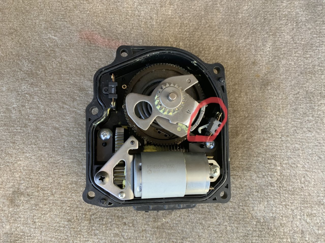

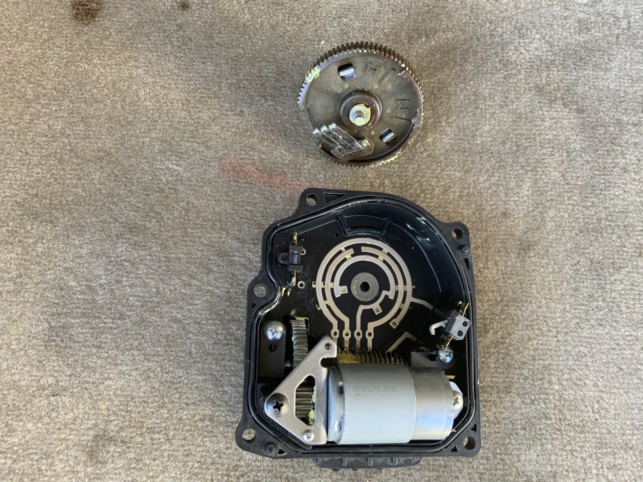

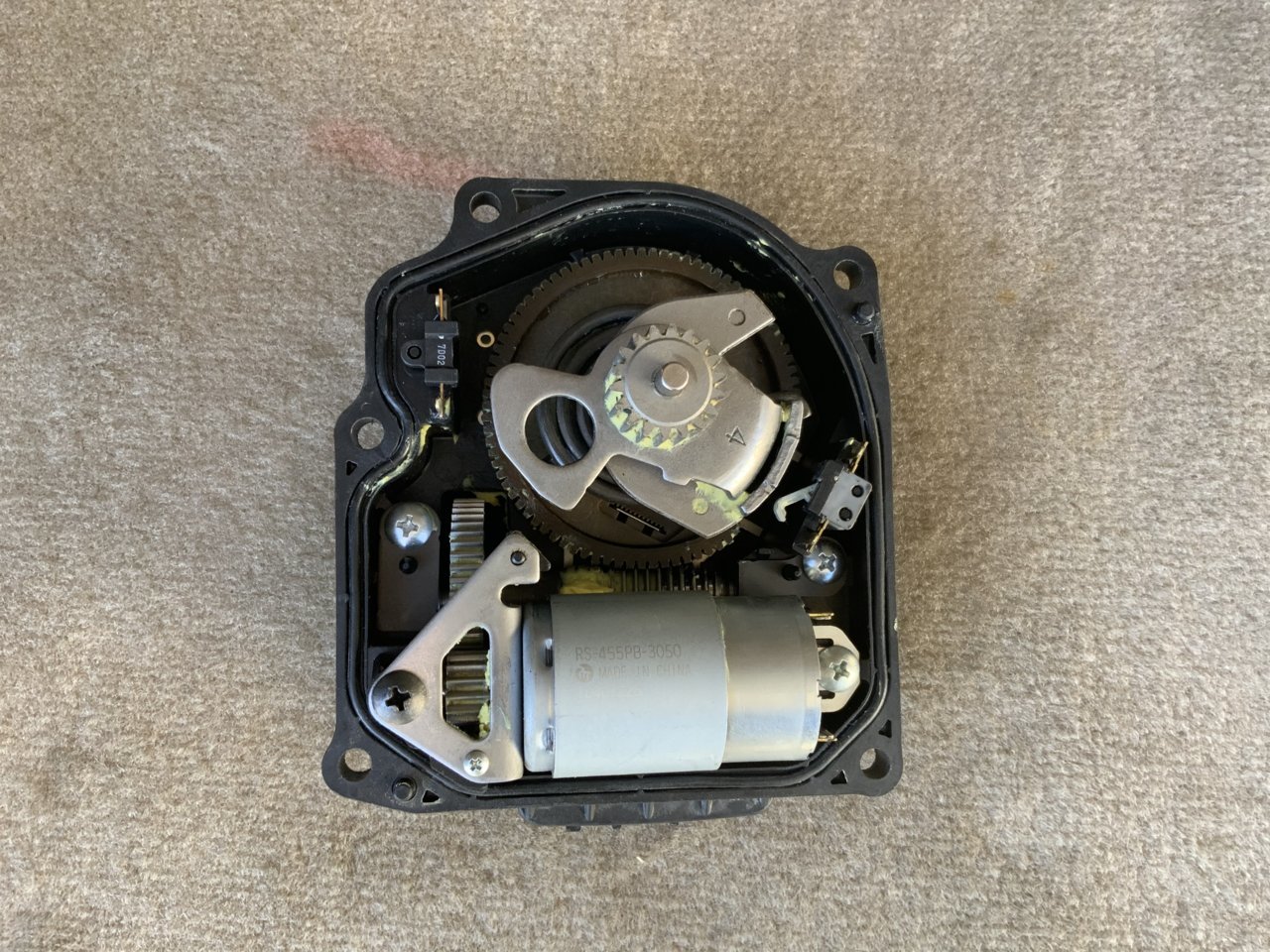

    Here’s a quick update for anyone who is interested. I read some threads where people disconnected the 4wd module for a few minutes to reset the system. Unfortunately that didn’t work for me.
    I decided to pull the 4hi actuator back off and test the actuator with it plugged in to the vehicle but not mounted on the actuator housing. When I moved the 4hi switch in the cab nothing moved on the actuator itself. I tried multiple combinations of 2hi and 4hi with the ignition on and off between shifts and still no movement from the actuator.
    I tried to manually jump power to the actuator from the battery and the only two pins that produced movement were the two on the far right. I plan to add grease again once I get it working properly.
    All this leads me to believe something is wrong further up the system. Either a bad 4wd module, relay, or 4wd switch. Does everyone’s 4wd switch in the cab make a sound when it is activated? Mine is completely silent and I’ve read some people mention there is a slight noise that comes from the switch.
