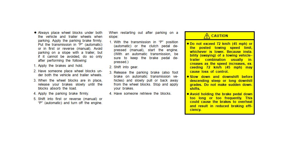

    Toyota says not to tow faster than 45mph. Has anyone here towed a large trailer(say 4000lb or higher) and experienced swaying, like they say? Is this necessary, or just lawyer, playing it safe stuff? I've never towed with this truck before and don't know what to expect.

    Owners manual addresses that too. They say to slowly decelerate and try and hold the steering wheel straight.

    That was done with a much bigger truck though. This is 1st Gen. So it might be different for a much newer and bigger truck.

    Could you screenshot the whole page?
    I’ve never towed with a 1st gen, or even been inside one. Not a lot of help here. Sorry.
    With a LDH, a properly loaded trailer, I see no reason 55-65 mph isn’t doable.

    I've towed heavy with my 1st gen I had previously. Lawyer stuff in my opinion, but you definitely know you are towing. Use your best judgement. You will feel the grades. Make sure you have trailer brakes and that they work properly.

    @Red913, I would consider this expert advise from a 1st gen owerser extensive experience.
    For me, I would get a good LDH, adjust properly, and see how your personal tow experience is. The CA experience might be a lot different from the “Rocky mountain” experience.
    If you feel safety is an issue, drop speed, maybe change load (I have needed to do this on multiple occasions), and make a decision after that.
    In my own personal opinion, the truck you have is more than capable with the loads you want to
