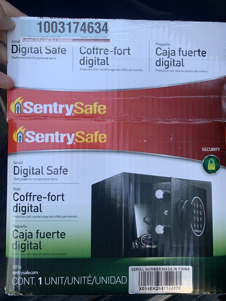

    Here’s my console safe.
    I picked up this safe from Home Depot.

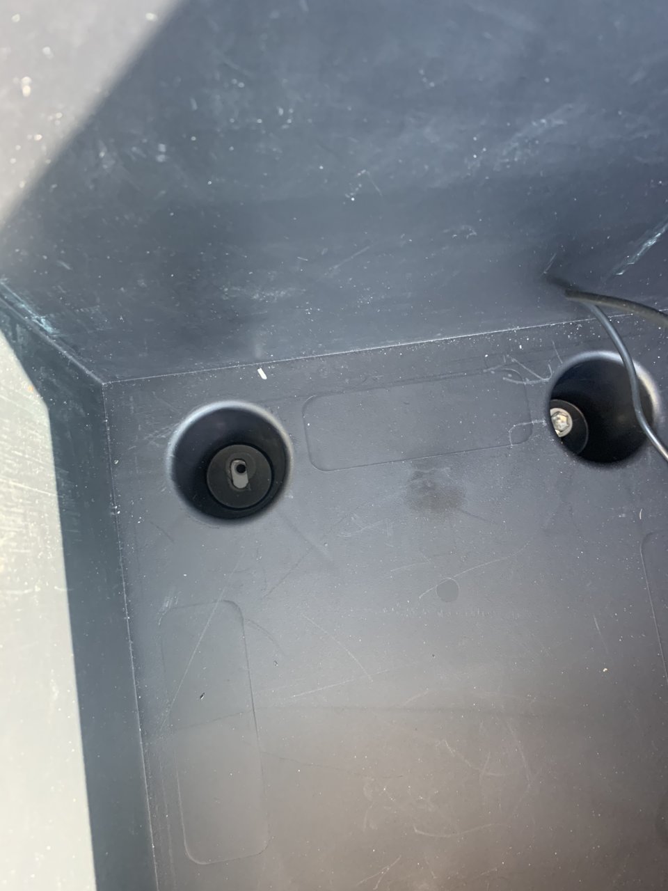

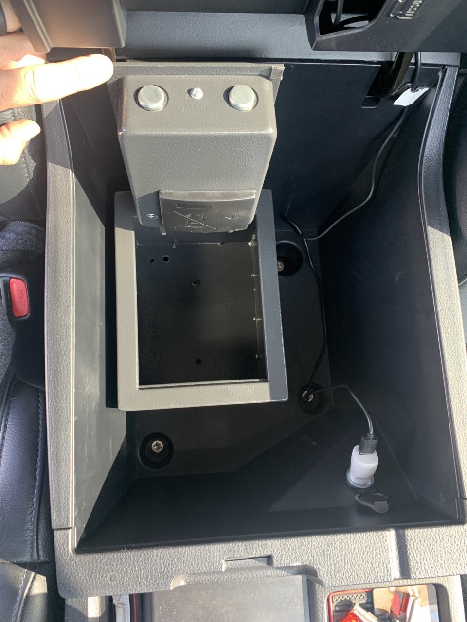

    Drilled a small hole in the back of the safe, replaced the console bolt with a longer one and done.

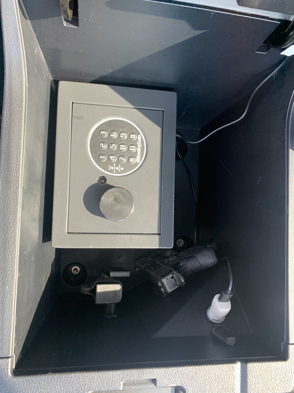

    $40-
    -Leaves room to mount a pistol and mag for quick access. Don’t need to open the safe door every time to access your items.
    - Still can have an organizer tray in place.

    Not bad for a budget safe idea. But keep that gun on your body, does no good sitting in a console.
