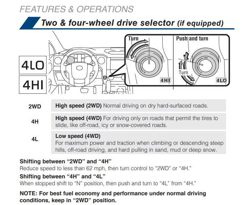

    Also in the manual it says to drive 10 miles monthly in 4wd to lubricate the system. From 2wd to 4hi you need to be below 60mph, I’ve switched from a dead stop to moving. try going forward or reverse to let it lock in if it doesn’t at first try. 4lo you have to stop, put it in neutral then turn from 4hi to 4lo, same process to go back to 4hi.

    I believe there’s a YouTube video on the proper steps for engaging your 4WD system. I recall 4hi you must be below 62 mph if you choose to engage on the fly. In the video I believe it says to accelerate and let off the gas and repeat until the 4-hi light is solid. Let me see if I can find the video for you.
