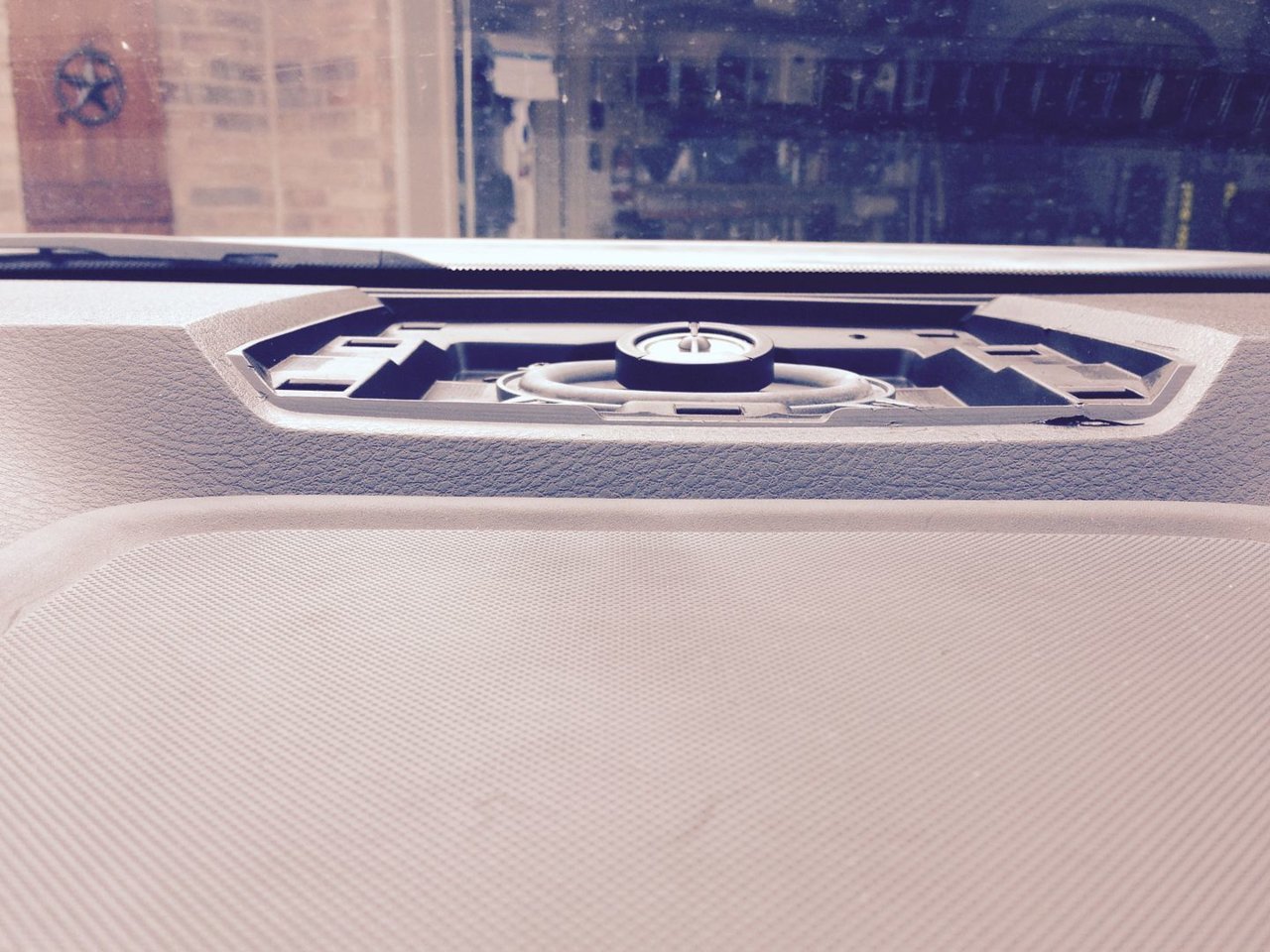

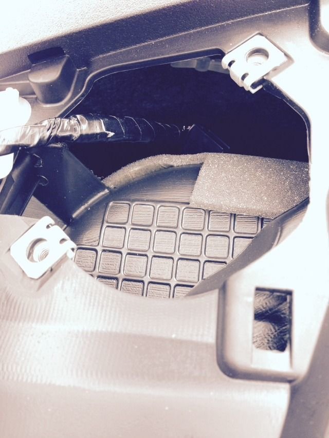

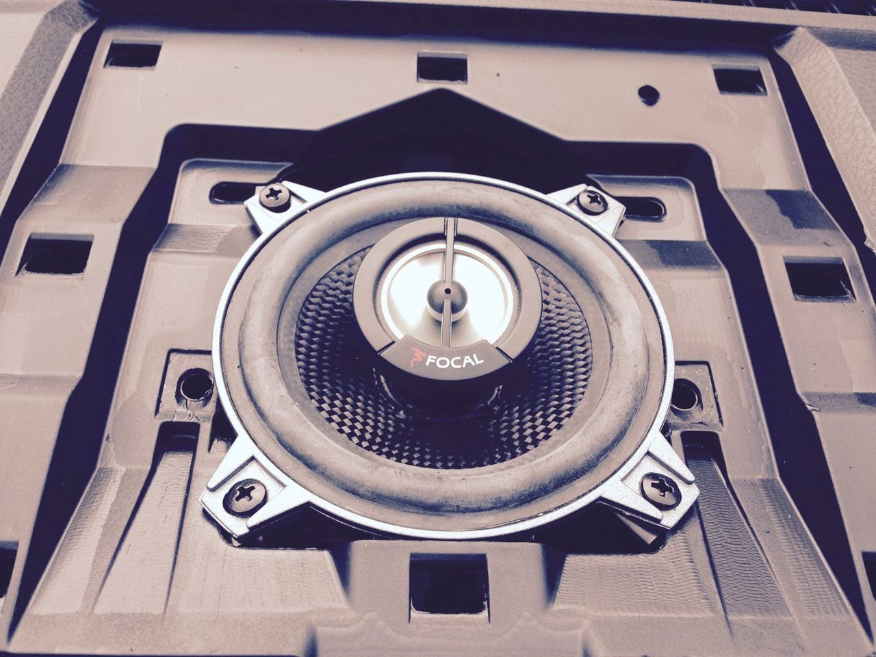

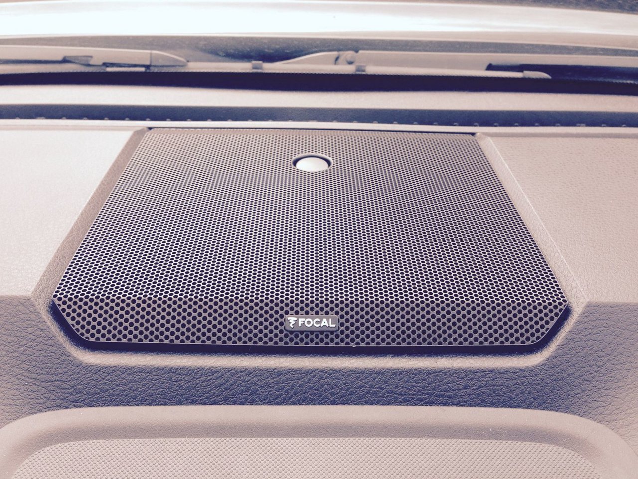

    I fit a 4" in the center dash when I was trying to make my JBL MS-8 DSP work and needed a dedicated center speaker....
    81AE6859-EE20-4A70-BB96-F8CB6B18B964_zps_858d62e043cdbc8d733bd8b26d9c02378fadee30.jpg EF91C618-0E67-4A20-96F6-0DAA1889D7EA_zps_bf4bd43cb091f5afed6cf96afc2a85dedbe2dcc2.jpg A8D4DF49-A8E1-4FCA-8441-6814C2B1AA15_zps_288cf52b4423c101fefa5195985ac4b365eb1b0c.jpg

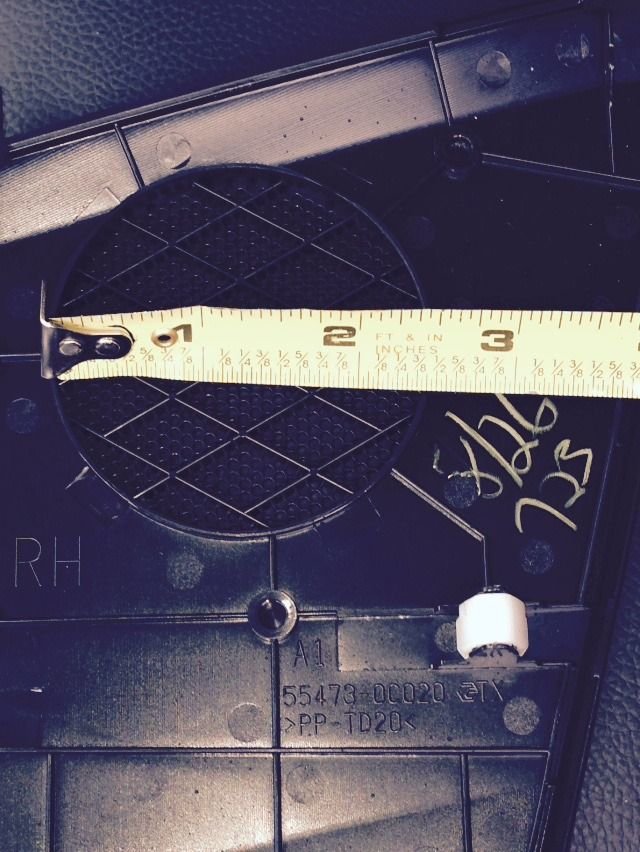

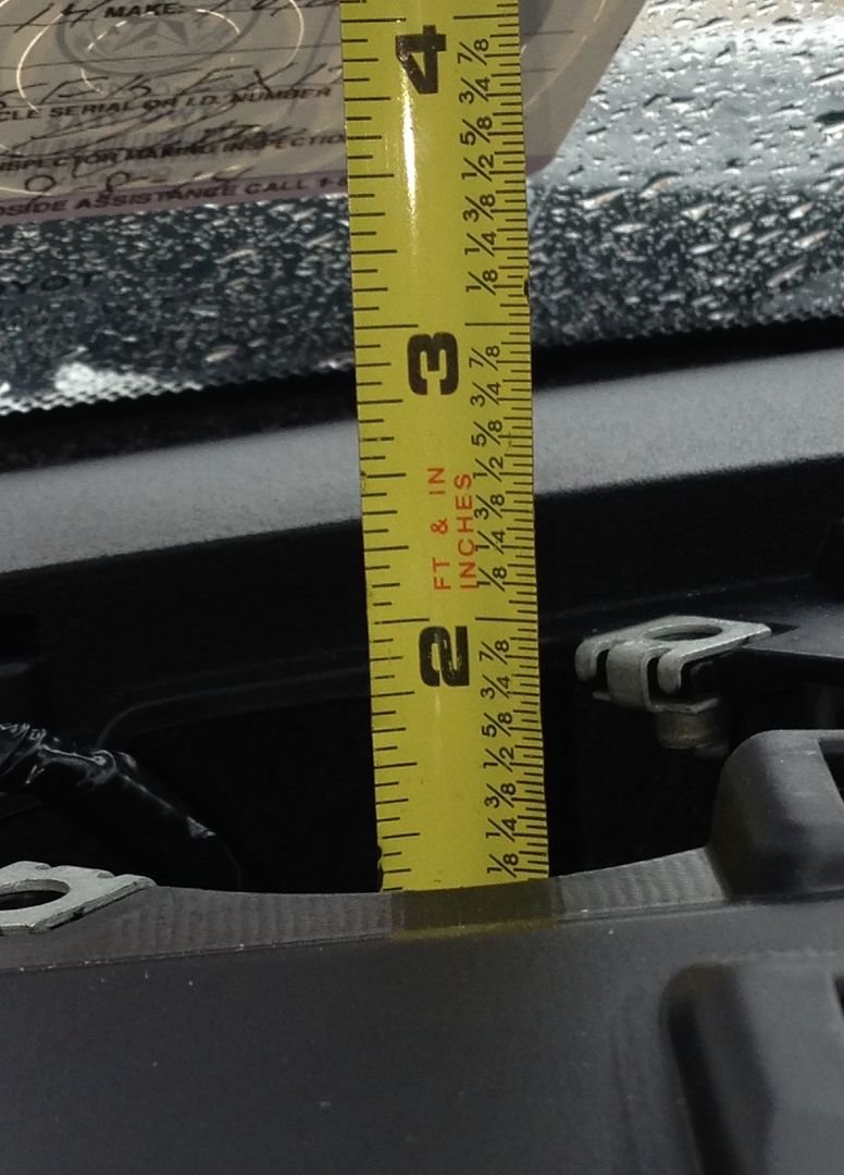

    But I don't see you getting a 4" speaker in the sides, width or depth..
    Unless you mounted it on top of the speaker grille...:eek2::eek:
    C05027CB-3448-4C6A-AE98-5A420B64A105_zps_d12e41cc6e16e1113f0d0e191e09227dc5f39861.jpg 1029C24A-C89F-44E3-92A5-1174DCE627F4_zps_db00b310ff6ebee86033e59bc139640025ece32d.jpg A4D39AD3-635E-4703-827C-046E99F10003_zps_2e1639d2eedfc2cc9fe88086d7dd94a7cb0e9081.jpg
