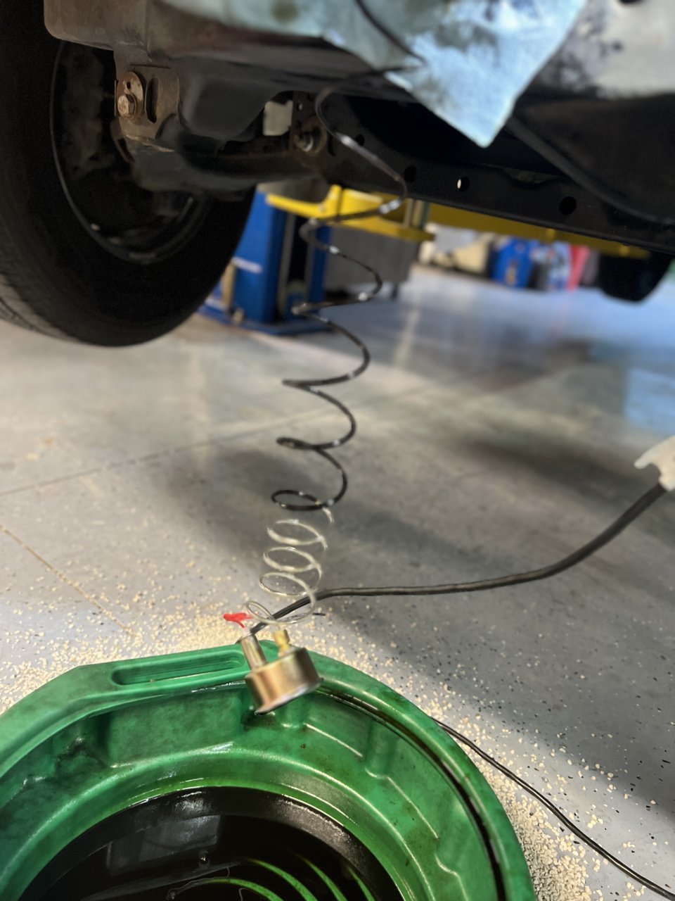

    What would stop oil pressure in using a mechanical gauge? I attached a gauge in place of the OE sensor at the oil filter housing.

    Not sure, but that might throw a code. And you have to let the rest of the air out of that little oil line. Dont nick that hose on anything. Had a mechanical oil gauge spray the inside of my nova with hot oil in high school.

    Are you looking at the gauge face or just the flow of oil in the line?

    I’m not impressed with the clear tubing, but it should flow to the gauge. Nothing seems to be helping get a pressure reading.
    Also I took many precautions to keep oil line rupture from happening.

    Gauge didn't show any pressure, nor did the new oil pressure tester before this.
    Each time removing something, there is oil coming out when removed.
    The clear tubing is proof the oil is not flowing to cause pressure.
    I removed the oil filter last night and will be changing brand names of filter to see if anything helps.
    Also, the filter housing has three holes, the other two are plugged.
    Anyone have experience with the plugged holes being alternate areas for pressure?

    My skidplate is on, you're gonna have to show us the 3 ports. Take the hose off the gauge, once the hose is full, reinstall. Do it with a rag & you might just be able to bleed it without making a mess. Everything up to temp & rpm when checking? Still thing the ecu is going to wanna see an oil pressure signal.

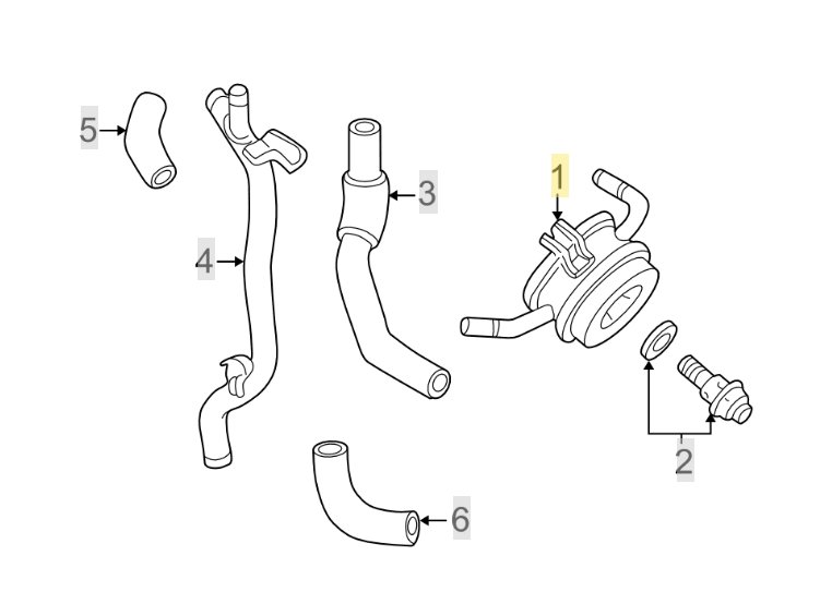

    On my OE parts website, this diagram calls the part between the filter and the housing, an oil cooler.
    Just an FYI,
    Part #1571050030
    Engine Oil Cooler
    Brand: Toyota
    List Price: $1,405.11

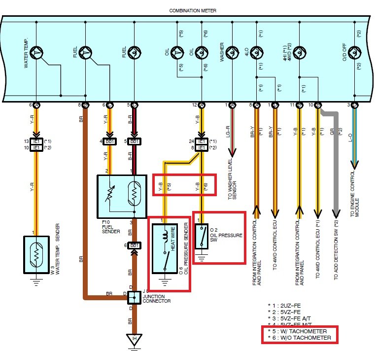

    The ECU does not receive a signal regarding oil pressure.
    Whether one has an oil pressure switch(w/o tach) or oil pressure sender(w/ tach), there's only one conductor and it goes to the combination meter only for the oil gauge(w/ tach) or oil light(w/o tach).
