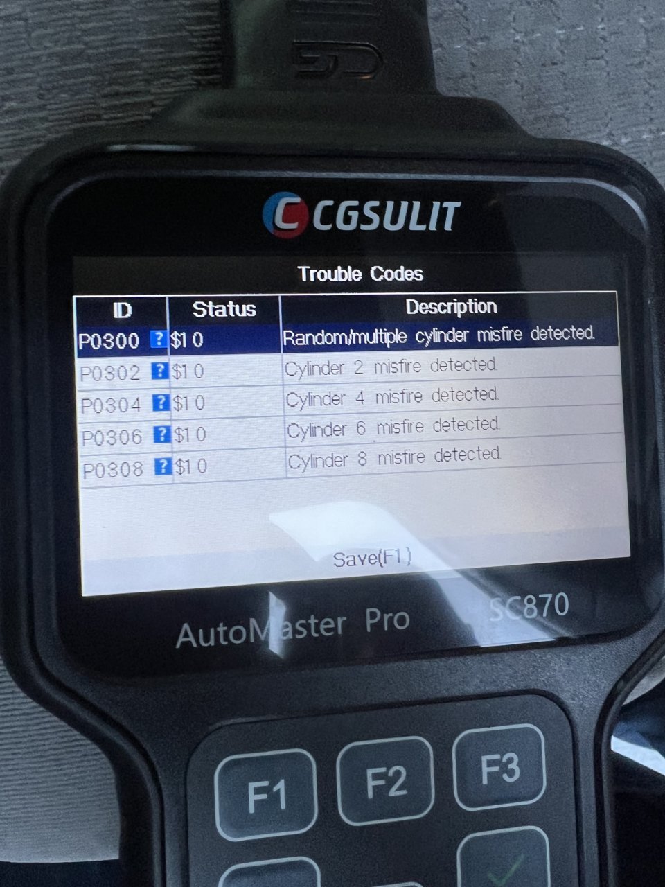

    Hey guys so my 04 TRd Offroad is acting up. We recently did all the oil seals at a dealership. We’ve got misfire on 2,4,6,8. Changed all the spark plugs. I’m getting codes for the low bank 02 sensors and a vacuum leak but no leak to be found. Any idea what’s causing my random misfires?

    Nope this is a Florida truck. Super clean chassis no rust at all. I swapped a new ignition coils and the misfire hopped but we ended up with 4 cylinders either way.
    this thing is misfiring for sure. Low power and sounds like it has a cam when I know damn well it doesn’t. Vibrates a good amount just doesn’t feel right

    We swapped them over to no avail. Still on the left side. Someone said bad ground? What grounds would I check??

    Well no code for the vacuum leak I think that was a stored code. My computer reads a lot of variables but I don’t know what’s normal so I have no reference. The ground looks find there’s no reason for it to have broken but it’s sure is tricky to get to. I’m trying to gather the most plausible possibilities because I’ve put in a few hours well many hours like half a day with no success. Not letting go of this truck way too nice to be ruined by a mystery misfire. I’ve been reading all over the forums looking for my solution. I don’t see any fuel leaks but I was gonna try some fuel injector cleaner although I don’t think that’s the issue. I put in a new o2 sensor and it made no difference as well

    My misfire is bank 2 2-4-6-8
