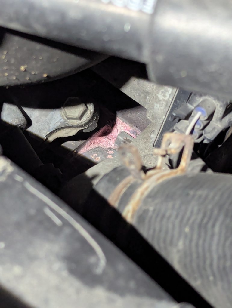

    My experience with limp mode in my Tundra has been a CEL for a knock sensor. When that light comes on, getting the truck to even 35mph is a major chore. I recently had to drive to move a mattress for a family member, drove it with the code reader hooked up so the light could be cleared if it popped on. Yeah, I know a rodent got under my intake and chewed up some wires (confirmed with a borescope camera), just haven't had the time to get to it yet (not my daily driver).

    I just know I saw a rodent nest under my intake with the camera, maybe even a dead mouse. I'm assuming the wires are chewed. My P0333 code pops on most often on start up, or within 2.5 miles of start up. It is certainly quite annoying and it has popped on in really inopportune times before. I've parked the truck until I have time to pull the intake off, hopefully this weekend.
