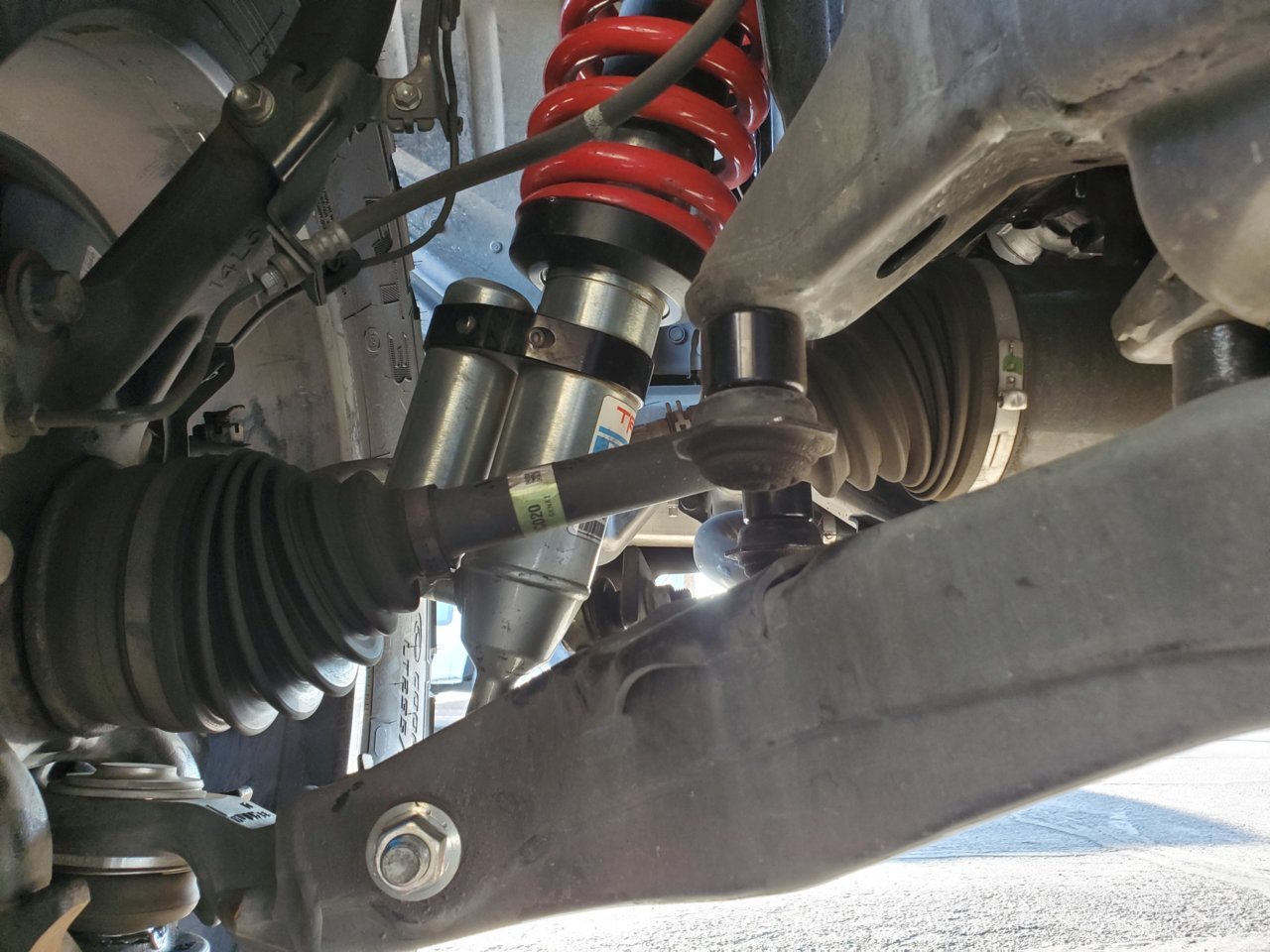

    Hi everyone,
    New to the forums here. Just got a 2021 TRD sport 4x4. Installed 295 70 18, 3” spacer lift, and Camberg upper controll arms. I’ve been a little concerned about my cv angles. I don’t off road, maybe just fire roads. Any input on angles? Maybe some photos to compare mine to? Are they really bad? Thank you.

    I’ve read a lot that if you’re 3” or less lifted in the front you’re good - no need for a diff drop. Many also report some disadvantages on the diff drop too.

    Well... the fins are touching so that will cause wear and eventually it will tear. Several years ago, I had a lifted Tacoma 4x4 and I made a simple mod to the CV boots that prevented the fins from touching. Check out my post over on Tacoma World:
    https://www.tacomaworld.com/threads/my-cv-boot-mod.190669/
    good luck.

    What fins?

    Netmonkey

    Such an odd dichotomy between Tacomaworld and Tundras sites on this issue.
    On TW anything like this would get met with the typical " those look bad, fins touching means fins tearing, do a diff drop, diff drops are pointless" yada yada yada.
    Yet here, one thing I've noticed is no one really stresses over them.
    First off, with drop bracket lifts the CV angles are usually like stock, so even though they're 6"+ they're usually safe.
    Your angles are quite aggressive, which honestly would be expected with a 3" lift. The thing is you could install a diff drop and it would correct the angles some but then some mention it chnages the angle of the diff and could lead to abnormal wear on the diff, I dont fully agree with that, but thats another issue.
    Regardless of opinion, I have noticed that yes boots wear faster with these angles, but its not crazy fast. It can still take a year, or years to occur. Once they tear you really have a good amount of time before you need to deal with it. You dont have to drop everything and get it addressed, but it will need to be planned for. Outer boot tears are a bit less concerning and make up most of the tears.
    Usages dont give you less risk, the CVs spin regardless of what you're doing. So the fins will rub and wear even if you never touch dirt.
    You have the option of reducing the lift to fix the angles, do a diff drop to fix them, or just let it be and see how long they last. Should mention that even stock angles eventually tear, and even then, theres always that random risk of catching a twig in the boot.
    I have a personal rule, based off nothing empirical, that if more than two fins touch I fix the angle. Even stock boots will get a two fin touch when turning. So I consider that permittable, even if the two are touching all the time. In your case, it looks like 3 are touching on both side. A diff drop is a cheap option, I would give it a shot.

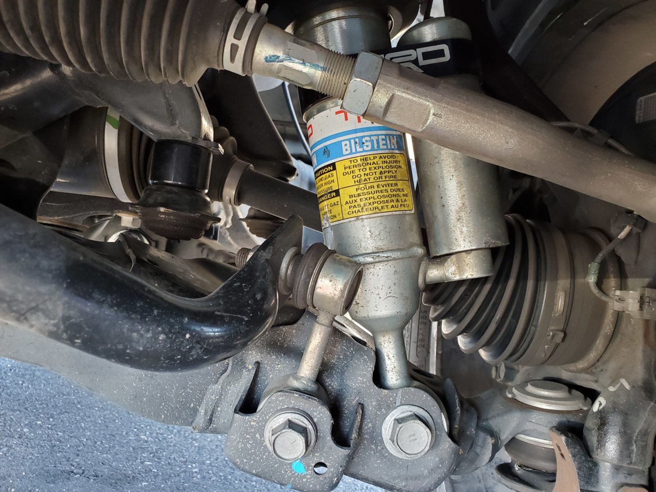

    My angles are about the same. I'm a little over 3" up front. Maybe 30k miles on mine so far and no issue.

    Those are the TRD Pro shocks (Bilstein version) and provide 2" of lift. I'm also running coachbuilder spacers for an extra inch and also a different collar on the coilover from Westcott Designs.
