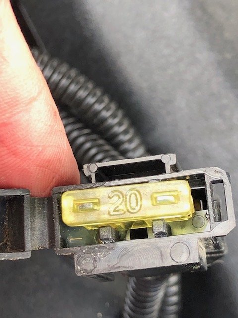

    Can someone check what fuse they include to go to the battery? I lost track of it at some point and just tossed a 10amp in there and it blew on me today. Wondering what they ship it with.
    Thanks!

    29,521
    20 Amp

    It's a 20 amp..
    Took 5 minutes to get the damn cover open...:eek2::confused:

    Thanks guys! This is why I love this forum, 2 answers within 10 minutes. Going out to swap out to the correct size. Appreciate the help!
