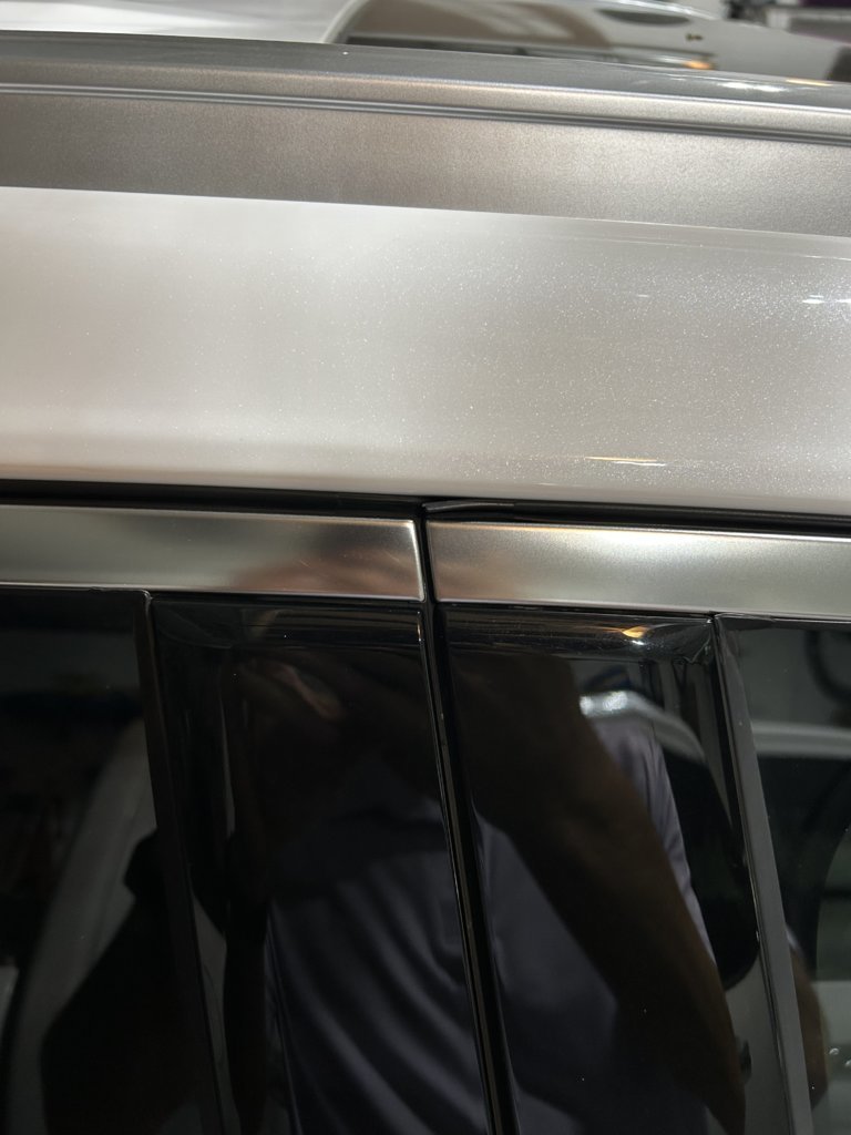

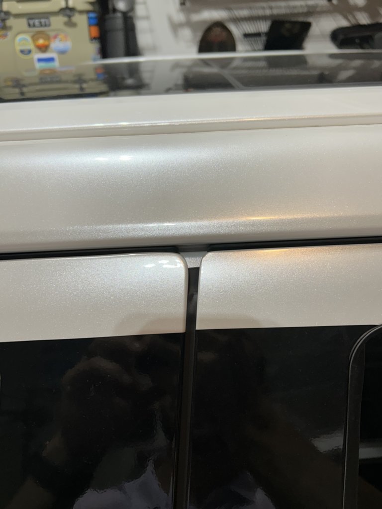

    I drive a new to me 22' tundra capstone. Got some pretty aggressive wind noise coming from driver and passenger side.
    Using a decibel reading app, my truck at 68mph is about 4 to 5dB louder than my wife's Hyundai palisade. I'm wondering if its not because of this large gap between the top right of the front door and the top left of the back door. First picture is of the gap on my truck. Second picture is my wife's palisade.
    Does everyone have his same gap? Has anyone attempted to fill this gap with double backed insulation tape? If so did it help with wind noise?
    Thanks everyone.

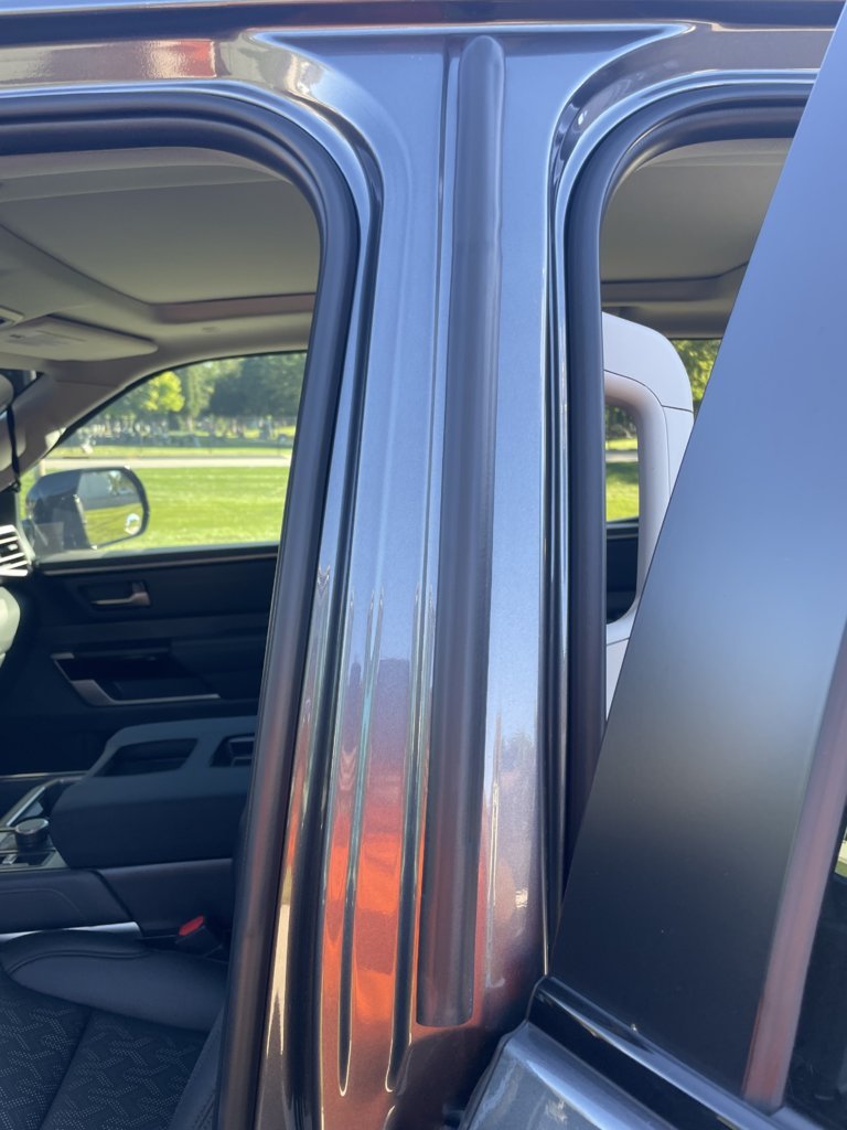

    IMG_5580.jpg When you open the doors is there a verticle weatherstrip on the b-pillar?
    Toyota may have added that on more recently.

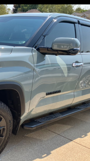

    TRD Air Filters, Front door windows tinted to match the rears. Wheel locks, Talons Garage cat shield, Tyger Automotive soft tonneau cover, WeatherTech floor mats with Tuff Skinz Custom Emblem kit, Toyota OEM Emblem Black Out kit. AVS vent covers on all four doors, Red Tundra letters on front bumper & TRD highlighted in Red on front grille. Tailgate Tundra Letters in Black.
    I put AVS side window deflectors on my Tundra and I don’t hear any wind.
