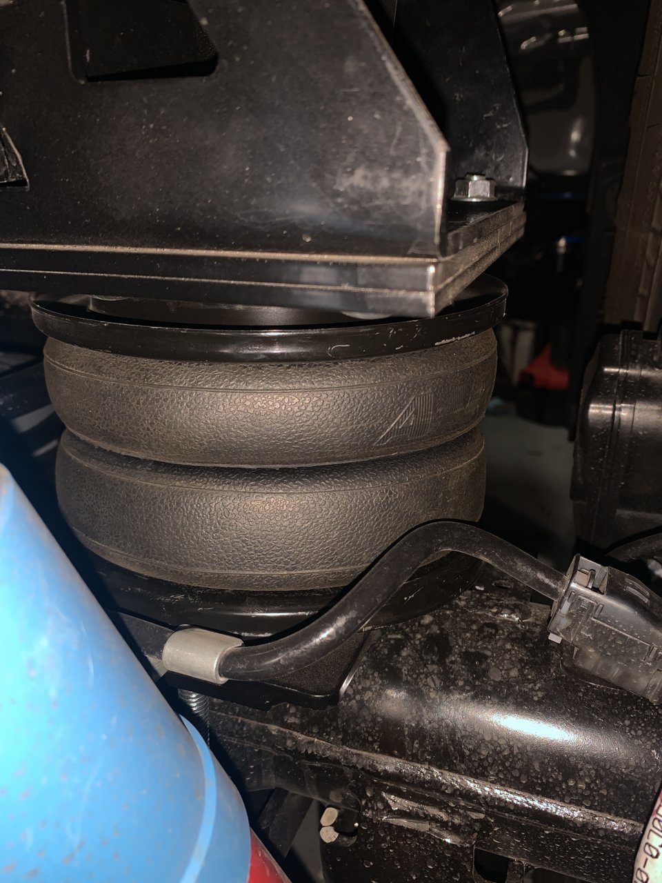

    Can a fellow 2022+ stock suspension tundra owner help me out. I’m looking for the distance between the bottom of the frame to the top of the rear axle near the rear shock axle mount. I just installed a 2022+ tundra air lift rear tow bags on my 2023 sequoia. I’m just checking dimensions to see if I need a rear spacer or not. FYI for anyone doing this there is some slight mods required via band saw but it did bolt on without too much effort. Thanks in advance!

    Tundra bag on a sequoia
