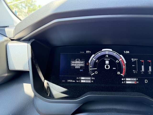

    Step 4: Scroll down to “Identifying Each Wheel & Position” and hold OK

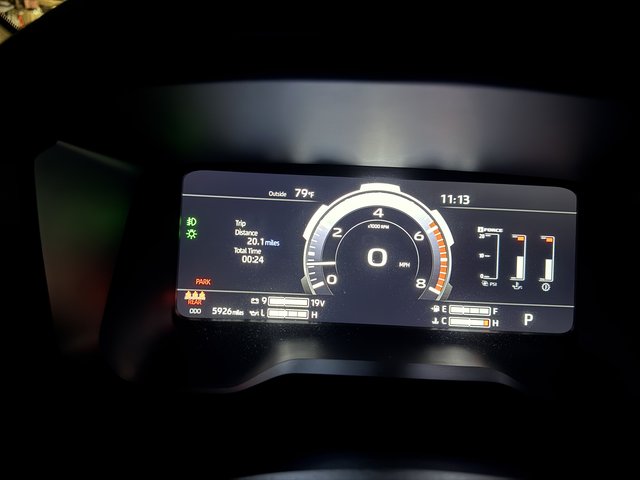

    Step 5: Your TPMS light will turn on, and the truck will start trying to program the sensors.
    If you scroll to the TPMS menu, you’ll see this.

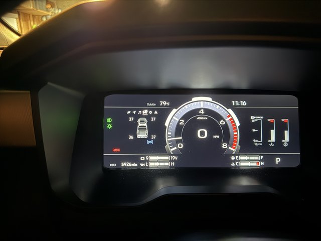

    Step 6: Drive! Mine took about 20minutes of freeway driving at about 60mph. The tpms light should turn off and psi should appear.
    Hope this helps!
