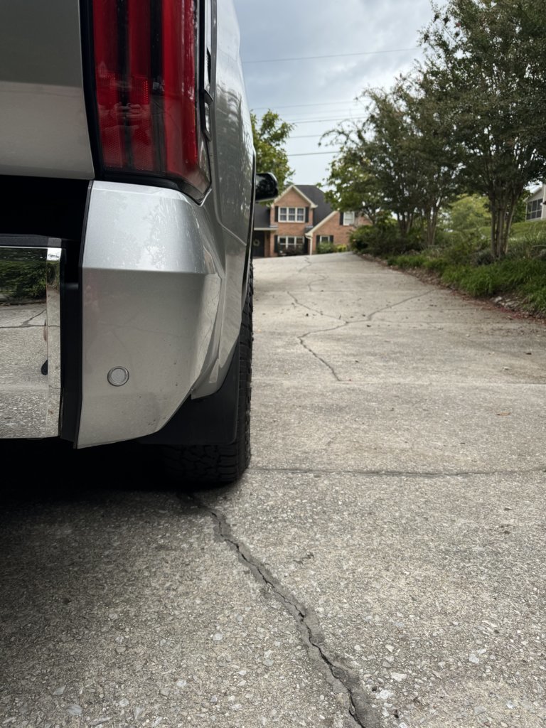

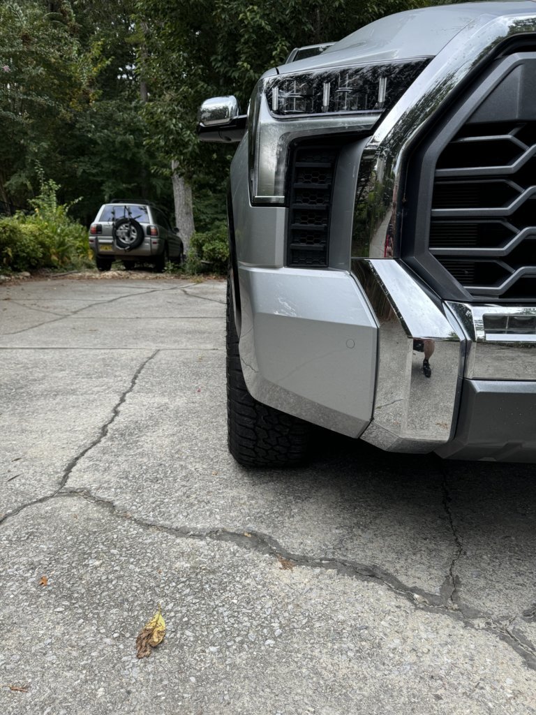

    Here are a couple pictures with the TRD Pro wheels installed.

    I mean, it's nice and all, but I prefer a little more poke. I have 35x12.50 on a Method wheel with a +18 offset. Obviously my 3" lift fits them, but the poke is what gives it the stance I love. Yes, my set-up is much heavier, and yes my mileage has suffered. But damn, it looks good.
    SoCal_Erik likes this.

    Were you expecting something different? It’s still an oem wheel with the same high offset as other factory wheels. No oem wheel is going to come out past the fender well.

    Nope! Just noting that they stick out a bit farther than the 20" TRD Offroad tires. Maybe I should say they fill the wheel well a bit better. They are almost an inch wider tire.

    Agree that it looks a bit better with a slightly wider stance, but I had a previous truck setup with a wider stance and it constantly threw mud down the side of the truck and I couldn't take that! It always looked terribly dirty.
