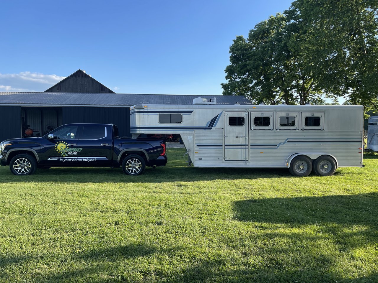

  8. Jun 4, 2022 at 5:38 PM
    Synergy
    Synergy New Member
    Dec 5, 2021
    #71464
    4
    Jamie
    Got mine today! Had to have one of my guys drive 10 hours to Kansas but she looks pretty sweet and pulls better than a 3/4 ton ford.

    Synergy - what kit was used. Looks great. Thanks for the pic

  13. Jun 5, 2022 at 7:50 AM
    Synergy
    Synergy New Member
    Dec 5, 2021
    #71464
    4
    Jamie
    B and W turn over ball. We were their field test before they sell it commercially. General public should be able to get it in a month. I was impatient so I volunteered my truck and sent one of my employees to Kansas to get it installed at their factory. It was a 10 Hour Drive each way!

  14. Jun 6, 2022 at 4:07 PM
    Synergy
    Synergy New Member
    Dec 5, 2021
    #71464
    4
    Jamie
    Did our first heavy tow with the gooseneck. 3 horses full tack and hay so we should have been north of 10,000 lbs. Ran 85 on the interstate like a dream at only 2500 rpm’s and the turbo was at about 30%. Passed cars going uphill and only got it to 4,000 rpm’s. Honestly the thing rides better with a load then empty! Twice as good as the F250 we used to pull the trailer with and comparable to my buddy’s 2500 diesel. The air shocks automatically adjust to the load and tow + adjusts the transmission so it never works hard. Im in love with this truck. I was afraid on how it would handle the gooseneck but it’s a dream! Big shout out to B and W turnover ball for the priority install!
