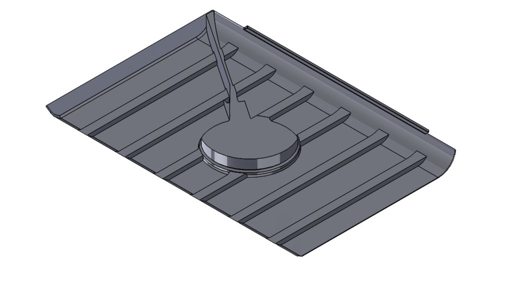

    Top center tray replacement
    • This technically has 3 pieces as well - the bottom piece in the model view is split in 2 (limitations of my printer bed size) then the top is mainly there as an insert for future additions and it has the 2 arms that reach out and help hold the 2 bottom pieces together at the split
    • The bottom is TPU and top is PETG - bottom is TPU to be flexible for installation and to not scratch up the trim of the truck and top is PETG for rigidity for mounting anything else
    • This replaces the top tray cavity
    • I re-purposed the 12V wiring for that cigarette plug for my wireless charger but I could add a USB connector to snap into my piece
    • This was my most difficult one to reverse engineer because that tray piece from factory was more complex than I thought
    • I have an idea to add switches at this location that could be retracted inside the cavity when not needed (think sunglasses holder technology lol)
    • Also thought I could put slots in that PETG piece and it could be like the infamous Bulletpoint insert that most people have but mine would be less expensive and more modular (also non-destructive to that tray for having to drill their mount)
    • Don't get caught up in the blue PETG piece below... I had extra material and was testing and that one was the one that worked. That would be a different color for sure. Also, yes, my truck is filthy...

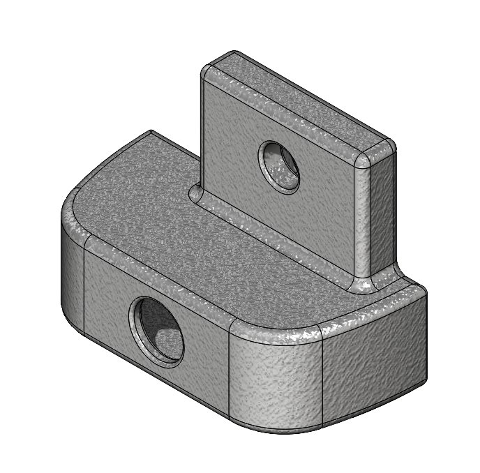

    Bed lighting switch holder
    • Just a simple holder for the switch that comes with the Matt Gecko bed lighting kit
    • This one is just one piece and printed out of PETG for strength and rigidity
    • The switch installed in the lower hole and there is enough depth for wiring and switch body
    • The top hole is through and the back has a depression for a nut for a close mount up against the truck bed body
    • This is designed to be installed on the back side of the dropped rail (mine is dropped for the bed cover that I got from factory)
    • This allows anything to slide past it on the railing system without interference and you don't have to drill into the bed to mount anything
    • Don't worry about the "clear" filament I used for this - again it's another that I had on hand to mess around with and this one was the one that came out right after tweaking

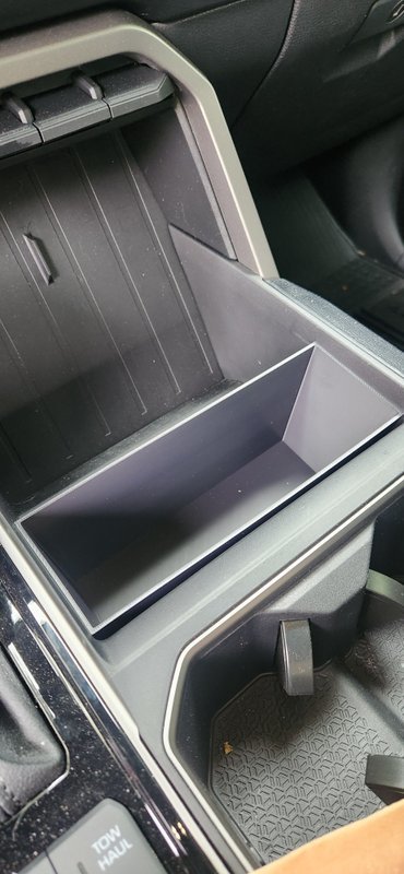

    Some great designs you have. Could you design a door for the rear storage tray on the center console lid?
    This one commonly found online is made from really poor materials and doesn't conform to the interior plastics well.

    That cover just attaches with double sided tape to the existing bin. Doesn't make much sense to have an open bin on the back of the console lid. You cannot use if for storage at all.
    Would be nice just to have a hinged lid of some sort on there. Or even just a cover for the bin with a slot cut for napkins or tissues. Just something to make use out of the space.

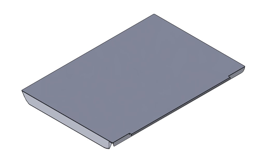

    Okay for the top center tray idea, what do y'all think about this? Just changed up the design a bit and added universal slots for AMPS mounting. This looks to be a bit more useful.
    kirkb and TucsonTundra1794 like this.

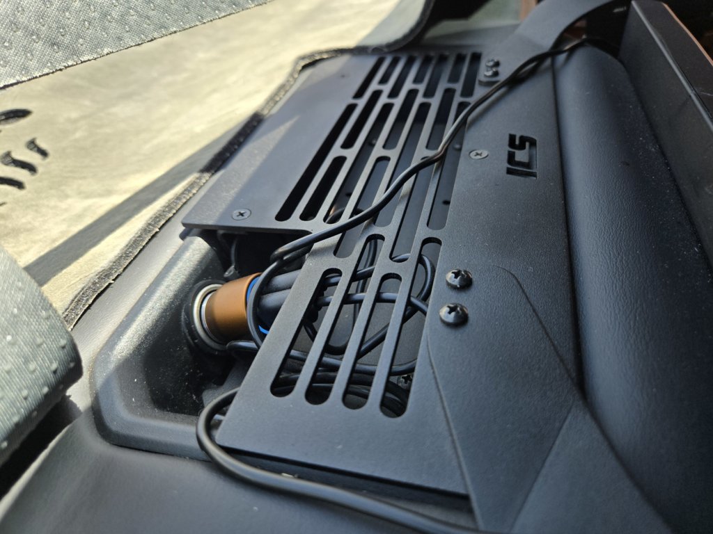

    Wish this was around before I bought mine. I would leave a corner open to allow access for something to be plugged in and if you do that make it large enough to use with the cover installed. If I want to pull my plug out I have to remove the 4 screws on the cover.

    Thanks for the advice on the plug. My print will replace the top cover and plug completely. You can unplug the cigarette plug from within the cavity and connect another set of wires to anything you want. I was thinking about providing that as an option to have a plug and play usb for up there that could interface directly into my print.

    I believe rago has a plate with the isb plug in the cover but I like the plug being under the cover for a cleaner look.
