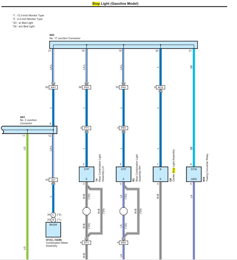

    Need to wire in 3rd brake light on a topper, pulled headliner and it's a 3 wire plug. Anyone know where I can get the matching 3 wire connector so I can make my own harness? Also it'll be wired into a 2 wire light, which of the 3 wires in the original connector would I use? Not looking to tap into the brake light harness, want to use the stock connector.
