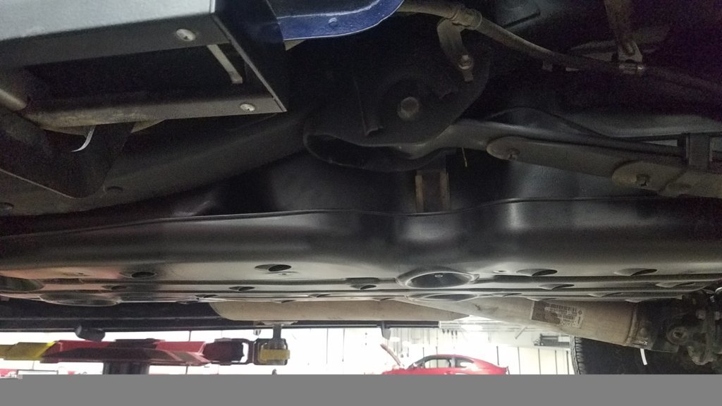

    I did this to my 2010
    Installed the Toyota 38 gallon tank. The transfer flow tank wasn't carb certified at the time and cost more than the Toyota tank. (That was 6 years ago) I'm sure things have changed by now.
    You need the extra front tank cross member.
    Move a couple of brakes lines (bend gently)
    Locate the emergency brake pivot up a few inches.
    The rest is plug and play.
    Your 26 gallon tank fuel pump swaps right over.
    All tanks are the same depth.. The 38 gallon one is just longer.
    I ordered all new straps so I could use the Toyota skid plate. They have studs to mount the skid plate.
