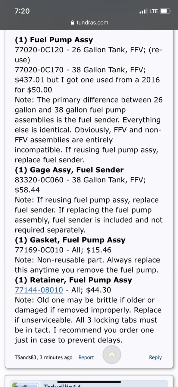

    So I got mine done by a dude in Santa Clara some fab shop can’t remember the shop name his name is Kevin. (408)674-9646 he did the tank and welded the tank mount you have to buy. The big thing is make sure you have the right sender. It’s not in the parts list and I had to drop my tank and put a new sender in. But dude can do the work

    Billy, isn't this the sender? https://parts.stevenscreektoyota.com/p/63173397/833200C060.html

    That’s it

    Mine ended up being a flex truck and yah it won’t track the gas then you get a code

    The pic you posted has the same part number 833200C060 that Bruce listed for the fuel sender. So now I'm confused. Which part number is for FFV and for non-FFV?
