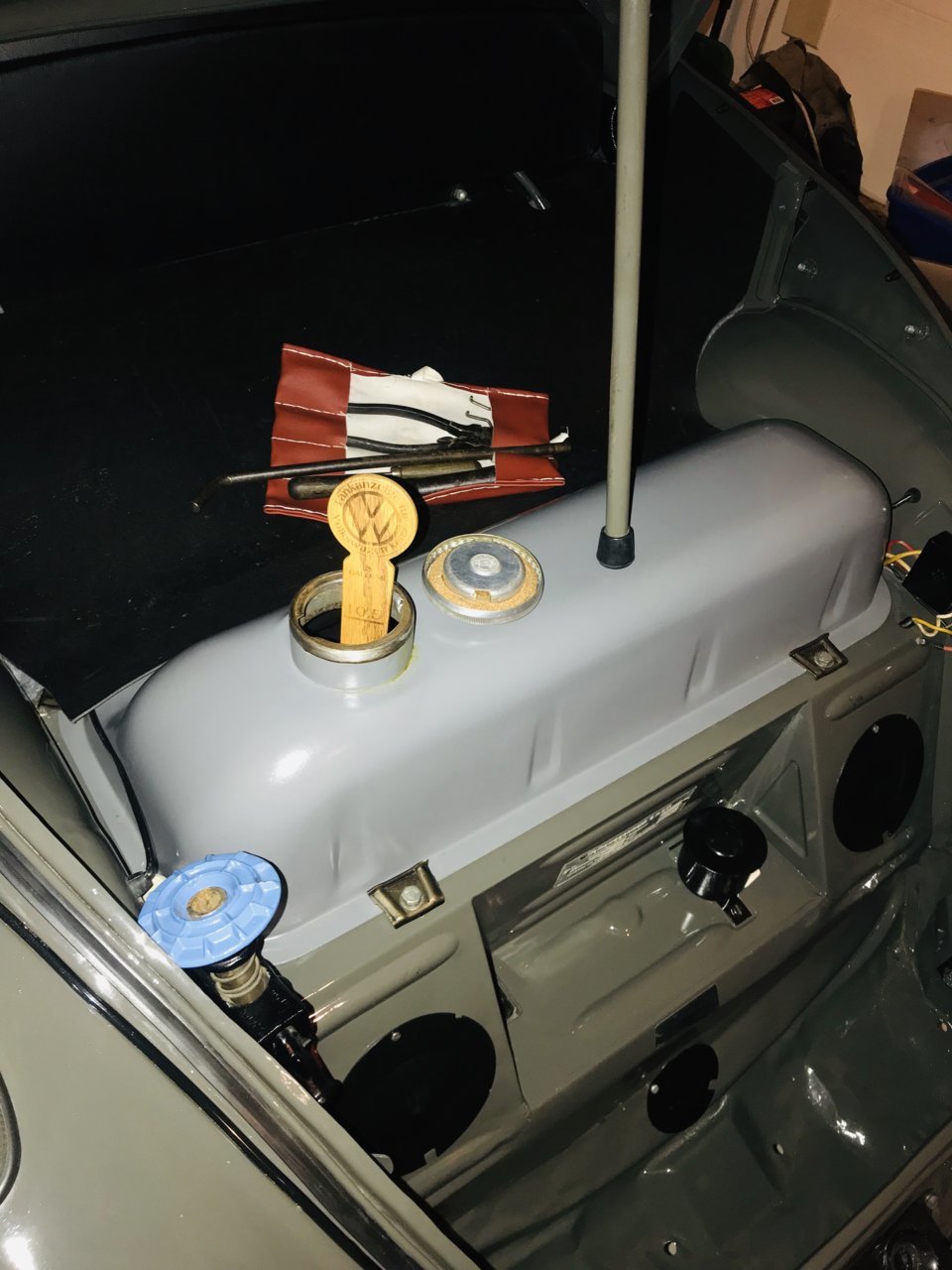

    For what it’s worth, my old VW doesn't have a gas gauge.
    You learn to keep track the old way, with mileage counters, or you can try to make one of these- a gas tank dip gauge: 30D4A9BE-FA43-4149-BE0D-E7A083253DC1.jpg
