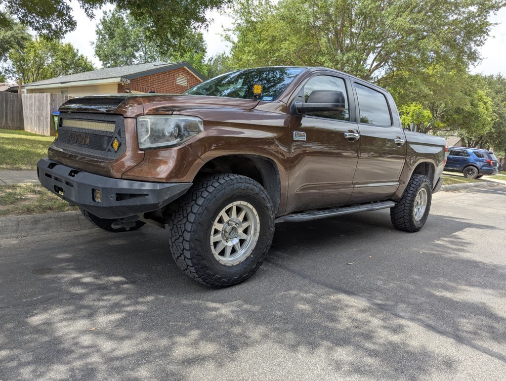

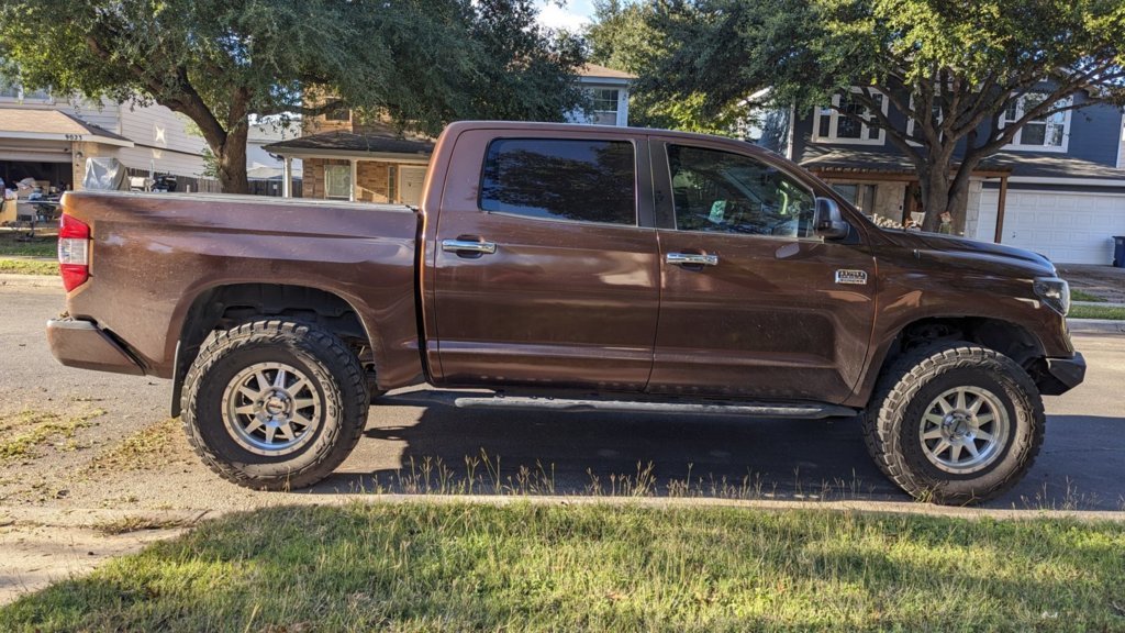

    here is how my truck sits currently

    Just got back from Discount tires, went with the Recon Grappler A/T's in 35x12.50R18.
    The ride is much quieter and smoother.

    Looks nice with new tires. I had the Toyo RT on my other Tundra also. I'm looking at Nitto recon grappler or the new terra grappler G3.

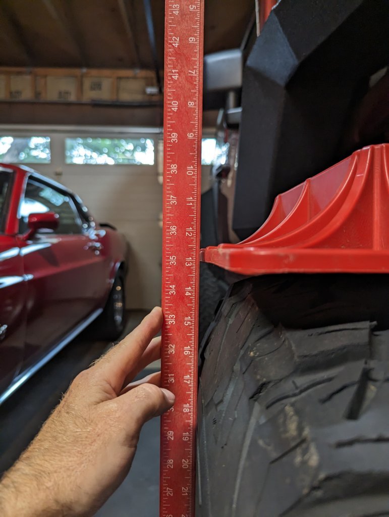

    To be fair, tires are shorter when on the vehicle and loaded. That’s how you get a contact patch. If the tire was off the vehicle it would be closer to 36”.

    valid point. I have 35x12.50x17 KO2 and they measure 33” while mounted…

    This will be unpopular but it looks dramatically better on 35’s. The 37s didnt look proportional to the lift height
