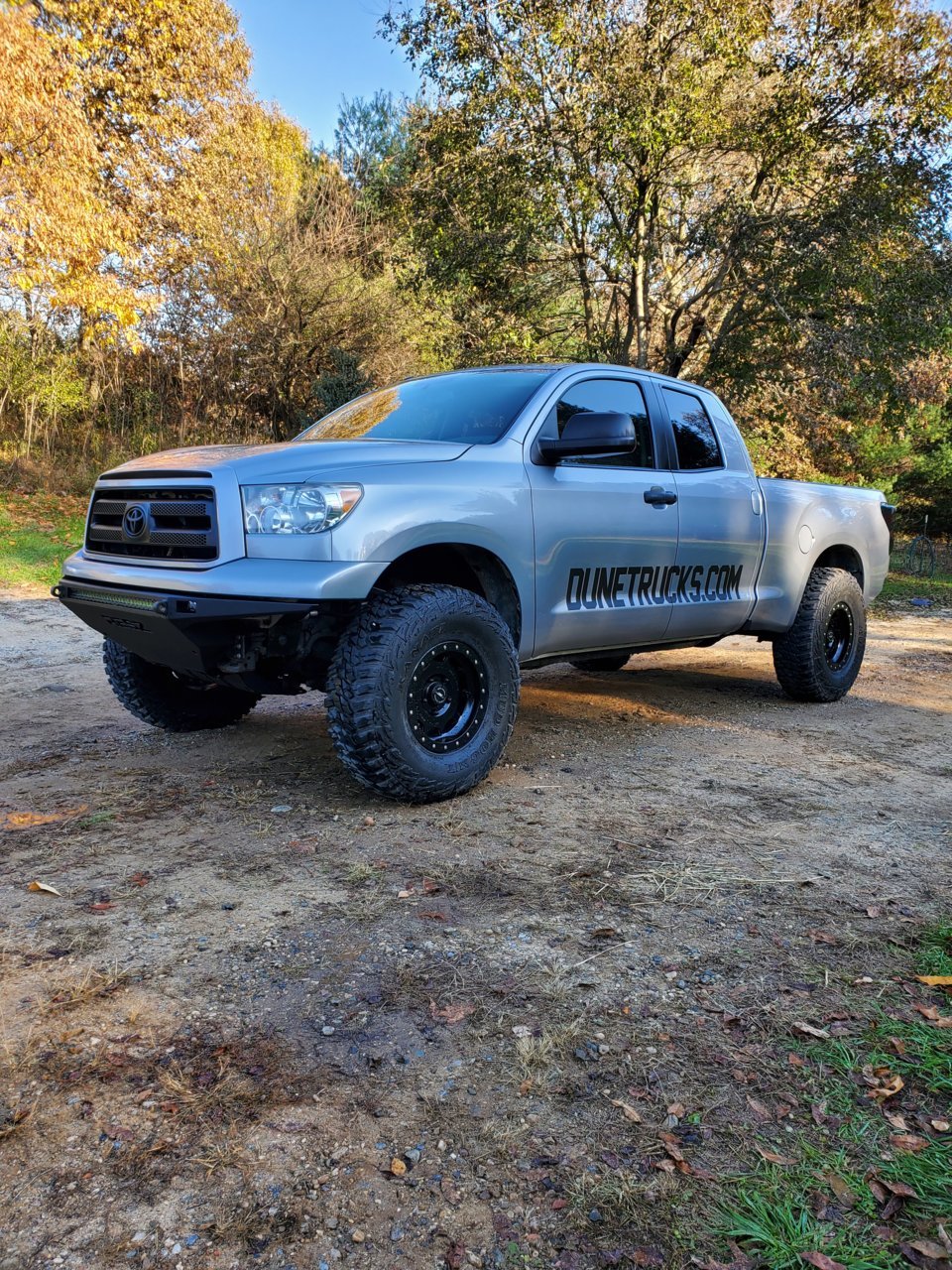

    Thanks guys. I thought for sure something must be different with my wheel wells for a little bit here. I think it's just the offset for now on the wheels I have. They're 18x9 with 0 offset. Maybe one day I'll go up in size. Definitely not for a while, though!

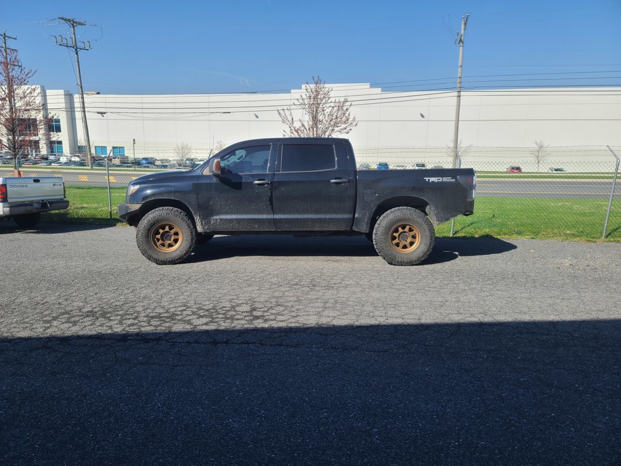

    Ya, you need offset much closer to stock which is 60mm. 25 will work. Get medieval on the body mount, trim the skid, lose the swaybar, move and remove plastic. 2" lift is actually enough.

    Nice! Specs on what you have and what you did to get clearance?

    Do you plan on wheeling it or not plays a factor. I have a aggressive bmc and folded pinch weld over I have method 17x8.5 0 offset wheels

    The only rubbing I have is on my front bumper and inner fender plastics at full flex

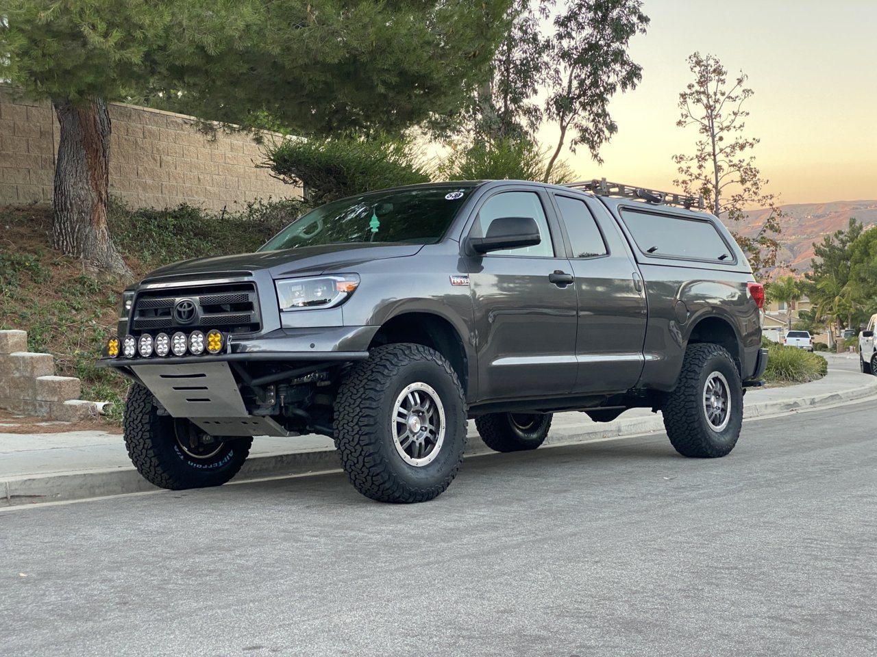

    37x12.5 KO2's on RW's. Cab mount chop and Fox 2.5 lift.

    That looks sick! I love the rock warriors

  21. Nov 30, 2021 at 3:58 PM

    a little bit at full lock. I never full lock it unless doing a U turn.

    If it makes you feel better at the end of the day, buy BFG cuz they run small. So "TeCHnIcaLlY sPeaKInG" it's 36.5. Just do a CMC, slight trim next to the pinch weld, push the caster forward, have wheels between +18-25 and you should be fine. I didn't wanna do 37's cuz of the work I thought it would take to do. So doing a "smaller" 37 made me ok with it. No big deal at all, super happy with it and having a more "plush ride" from the bigger tire
    OP I wanna see that shell :fistbump:
