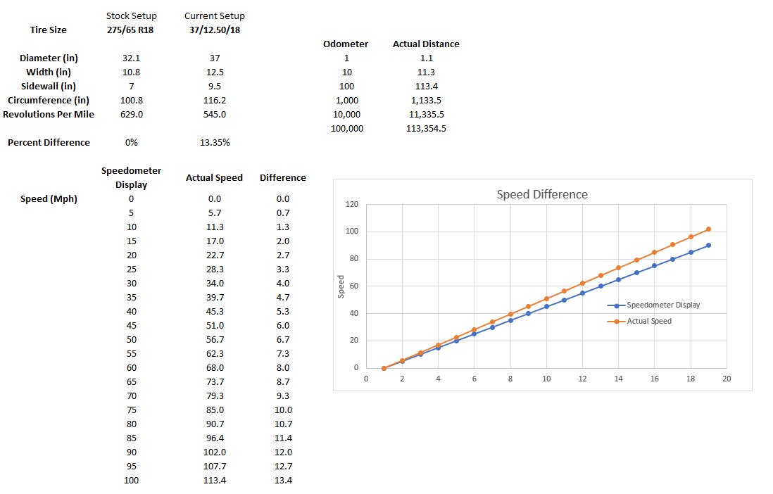

  29. Jul 26, 2022 at 7:10 AM
    #29
    Jeff_5_7
    Jeff_5_7 New Member
    Feb 20, 2021
    #59378
    1,433
    Jeff
    Houston Tx Area
    2007 RCSB 2014+ TRD Pro Conversion 5.7 4x4
    Full 2014+ Conversion Regular Cab Short Bed 4X4 2019 TRD Pro Grill, 2014+ Front End Swap 2014+ Interior/Dash Swap with TRD Pro Leather Seats, 2014+ Bed Swap with TRD Pro Stamping SOS 2/4 Drop Kit
    I threw this together quickly. Should be correct but if anyone sees a mistake don't hesitate to point it out. I did all this is about 10 mins but it should give some people a better idea what's going on.
    The 37" in tire is about 13.35% larger than the stock 18. This means your speedometer will be off by about 13.35% as it works on stock tire size. When the Speedometer display shows 70 Mph your real speed is 79 ish Mph (13.35% higher)
    Same for Odometer, it might say you have traveled 1 mile but in reality you have gone 1.13 miles. Not a huge difference but it adds up over time. After 10,000 miles on the odo, you have really traveled 11,335 miles. Do this for 100,000 miles and your truck really has 113,350 ish miles on it.
    eccracer104 likes this.
