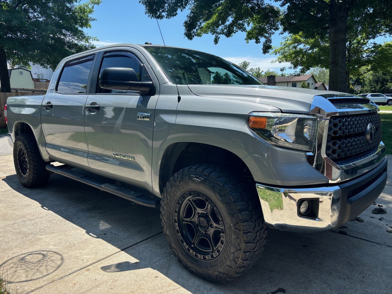

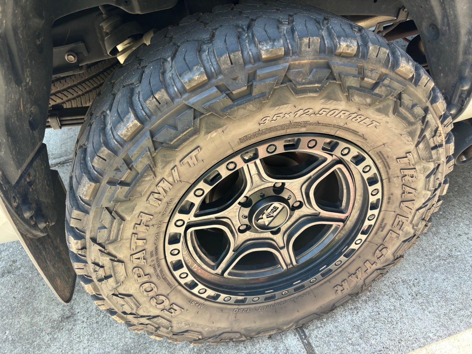

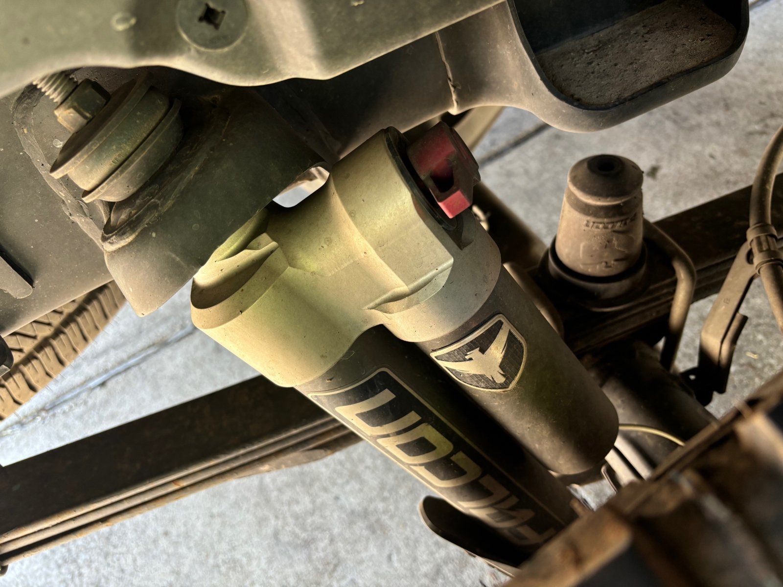

    When I bought this truck it had stock tires but these aftermarket wheels and Falcon 2.25" leveling shocks. I found these 35x12.50s on Marketplace for $300 total and I couldn't resist trying them. Took off the mudflaps and front plastic at the bumper. Full turn with no rub forwards and a slight bumper rub in reverse so had to shim the bumper.
    Only other problem is, the tire shop said "these will never balance" so they used balancing beads, which are not working well. Gonna have to try a regular wheel weight or powder I recon unless you've got any suggestions.
