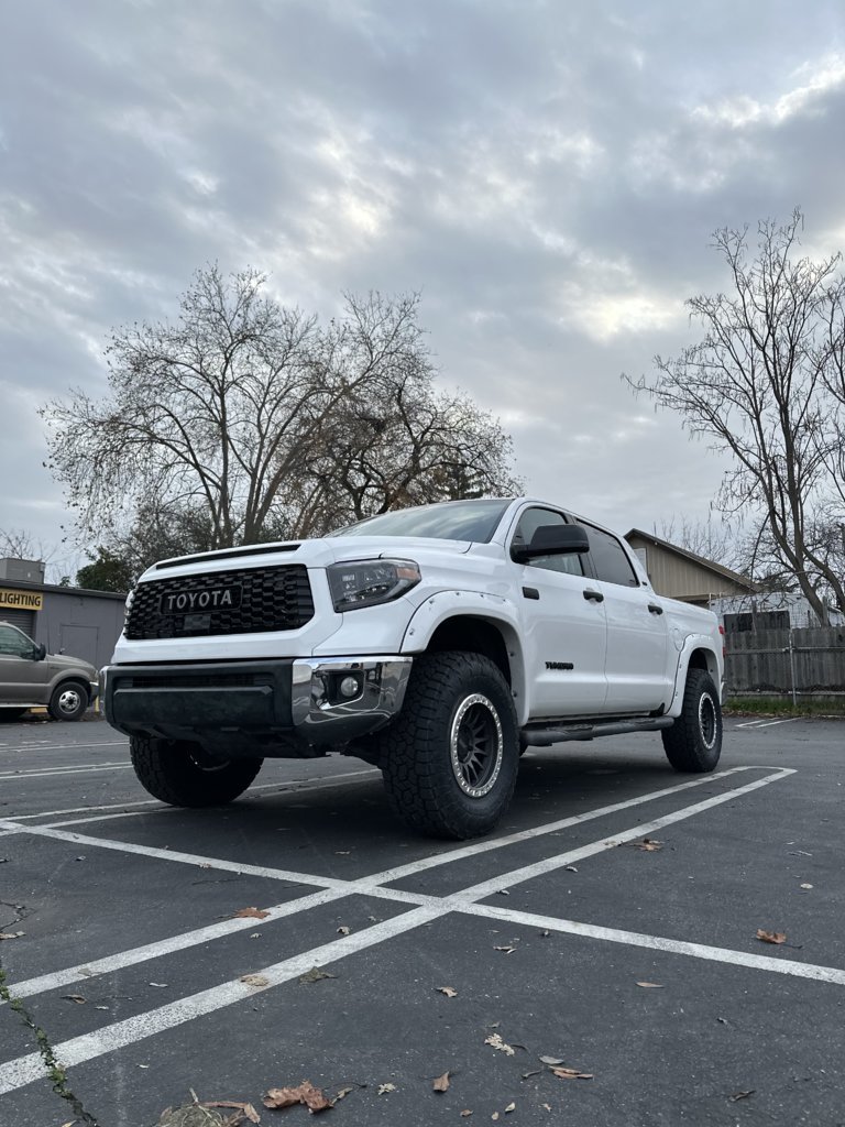

    CD8D6E05-B3DF-41CE-80B4-E3F182785E78.jpg I went from cheap 33s that weighed more than my 35 12.5 17R Toyo open country at3. No regear or regrets lol. Looks awesome too.
